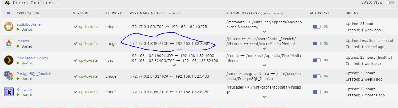

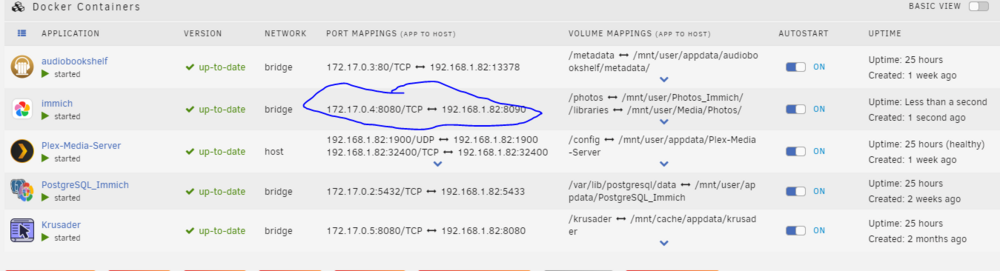

  11. As a follow up, to test this, I stopped Krusader, changed Immich host port to 8080 and restarted it. Still can't access the WebUI, it just returns a message that it can't connect.
  12. I am trying to get Immich up and running and have followed all the Spaceinvader One's instructions from his videos but after install is done I go to access the WebUI and get an error that it can't be reached. I did run into one issue that the default container port (8080) is the same as Krusader. I changed the port to 8090 and it said it was successful, but as I mentioned, I can't access the web UI. When I look at the docker container I am guessing my issue is with the port mapping, but I just don't know how to fix this. I have attached system log and a text copy of the immich log as well. immich.log.txt mediamadness-syslog-20240822-0246.zip
