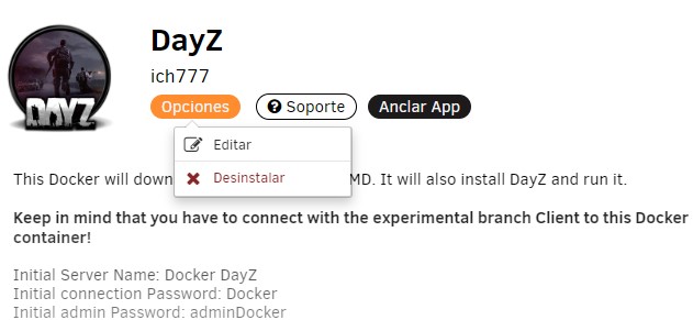

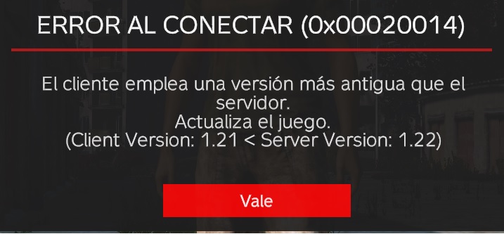

I don't know what command to put, I just want the docker to download the official version instead of the experimental one. the version that the server would have to download is 1.21
I only need the official version of the game to be downloaded instead of the experimental one, nothing more. now there is version 1.21 but the server is downloading 1.22
That tutorial is for steamcmd, but I don't have access to docker's steamcmd I have tried to enter the command in the docker console but it does not respond
What I want to do is create a server with the official version of dayz, not a beta. and when they update the game so does the server. Ok, I'll look at the link you gave me. thank you

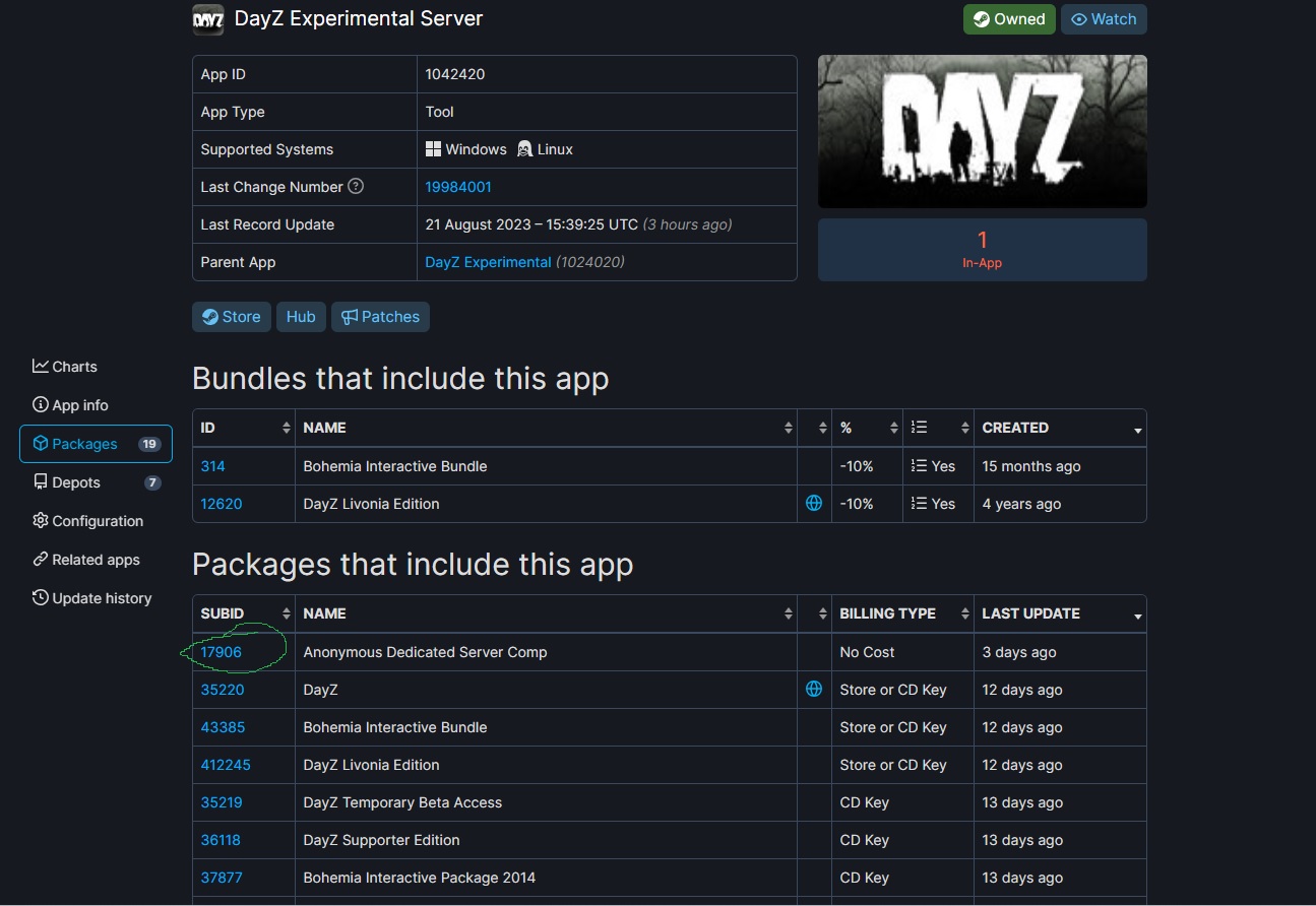

I don't understand what I have to put to download one or another version. For example, if I want to install the version that I have circled in green, what would I have to put in the game id line? thank you
nothing, the same, could you please tell me exactly what I have to put in the game id line for the normal version? because i think i'm doing something wrong

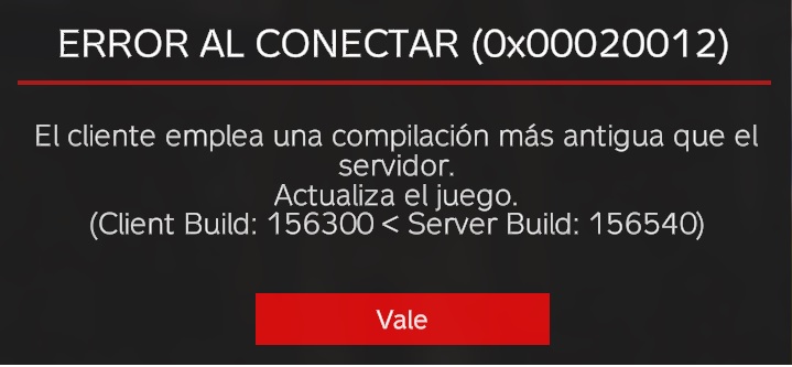

I don't have the experimental version, I have the normal version of the game and it's the one I want to set up the server for. To force the update of the server I think you have to put "true" where it says validate installation, and then remove it
Well, it's the same as I have, I don't understand why I have the client that you need and you the server that I need. lol thanks anywayy
I have the same client as your server. Could you please tell me what number you have in the "game id"? I have the game id 1042420
When I put 1042420, it doesn't download the normal version of the game, it continues with a later one, I have the game updated and it tells me that I have a version prior to the one on the server How can I make the server download the normal version of the game instead of the experimental one? thanks
