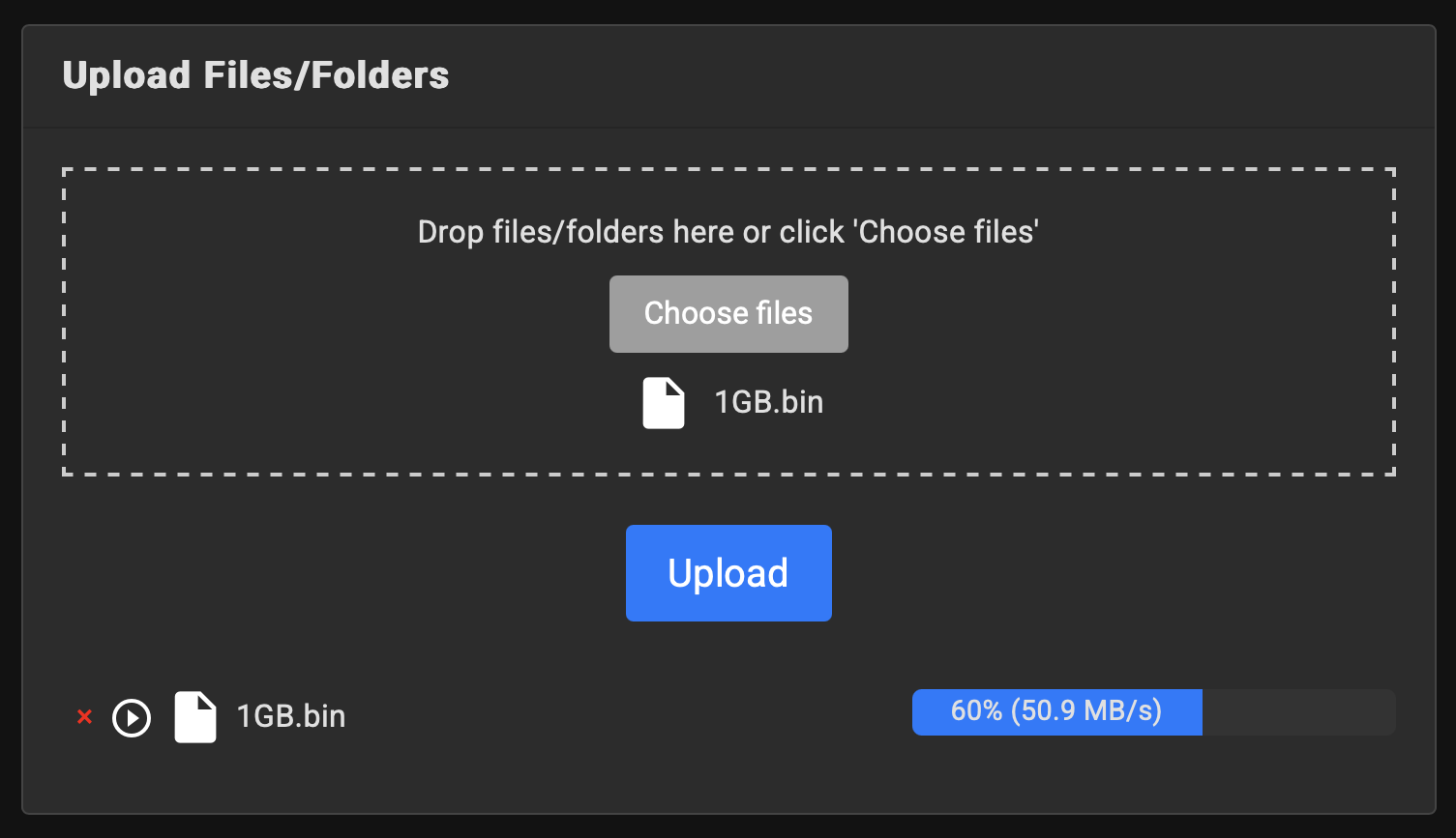

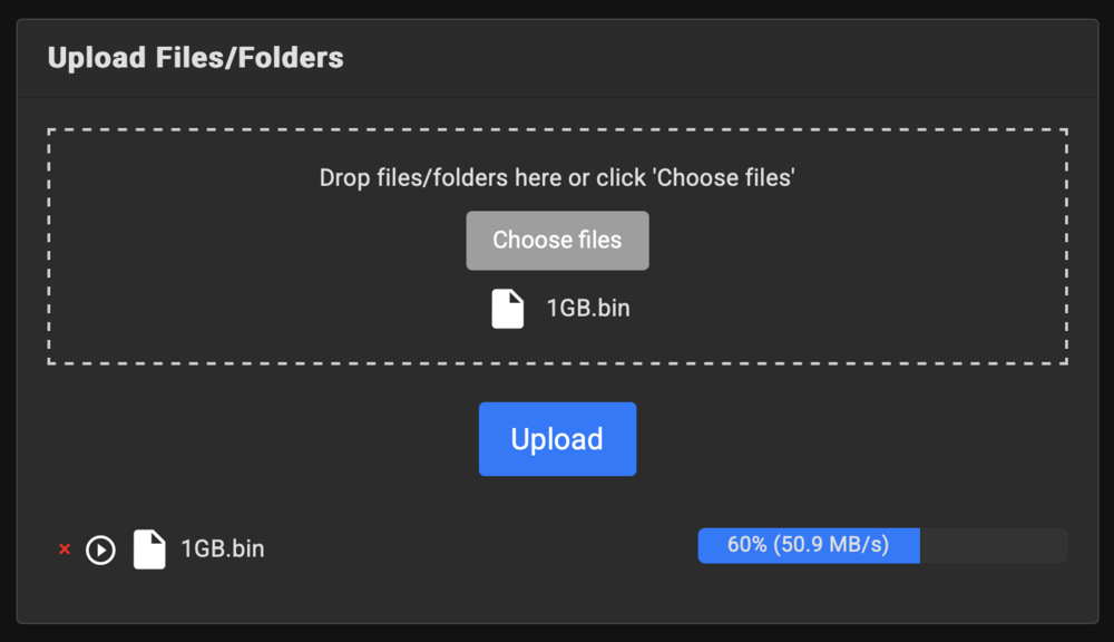

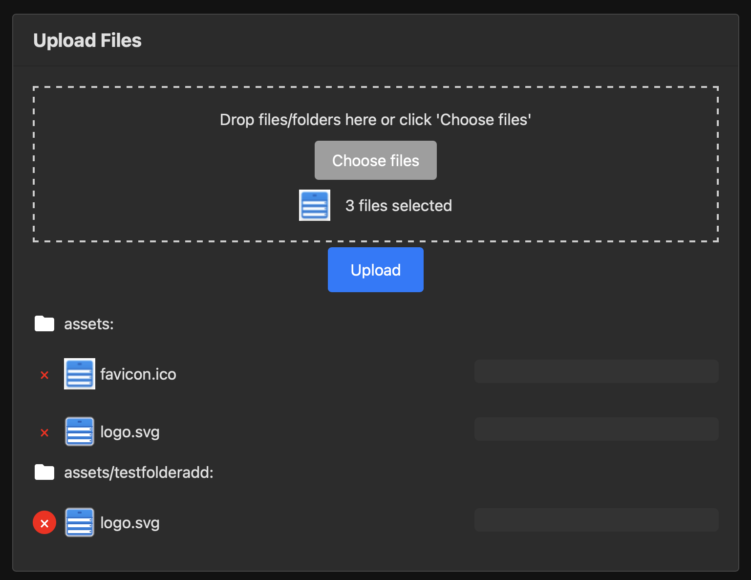

Thank you for kind words. Does it support resumable file transfers? - This currently isn't implemented. I did attempt this but at the moment it will fail and you will have to re-upload. Does it support uploading entire folders (and subfolders+files) at once? - I am actually working on this now but it is not currently implemented. Folder upload was implemented and updates the folder tree: I appreciate the feedback. Will look into adding these in the next few days.
