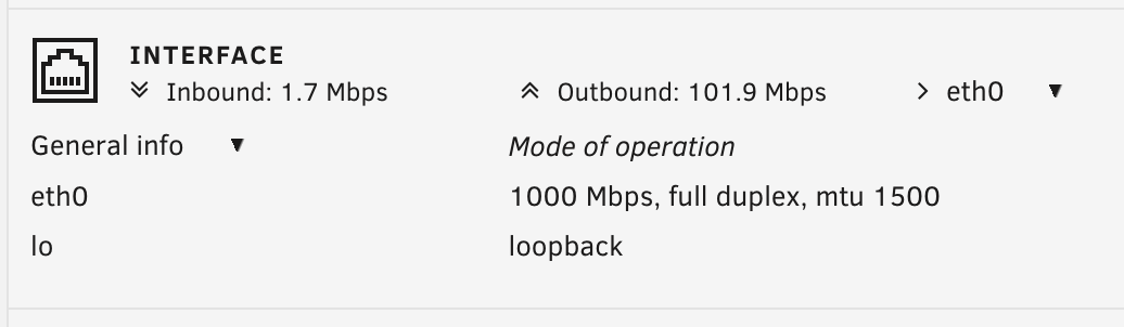

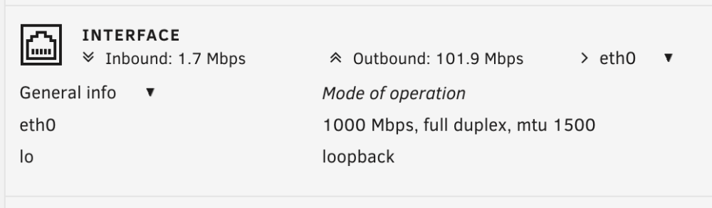

  13. Hey, I'm monitoring the Eth0 interface with Zabbix but it's not adding up with what Unraid is reporting. Zabbix is reporting a few Kbps, but Unraid is reporting 100+ Mbps. Unraid is correct as I was watching a film through plex container, which uses this interface. Is there something I need to change? Screenshots attached here of what Unraid web ui shows me, and what Zabbix is reporting.
  14. Ahh this was it thanks!
