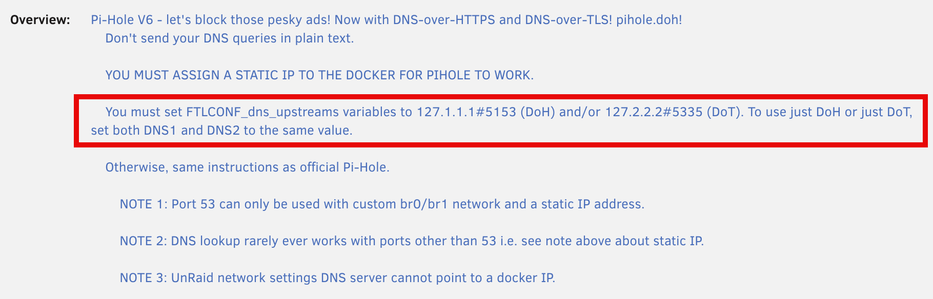

  6. Sorry, to clarify on the "latest" docker release if the Pihole tries to use "127.1.1.1#5135" as its DNS server for DoH it will endless throw this error. I assume it's because Cloudflare removed the "proxy-dns" command which would explain why it works on the docker "beta" release that uses "dnscrypt-proxy" instead. For the same error with "127.2.2.2#5335" that looks like user error. The docker overview when editing it or installing says this: Following those instructions I set the second DNS server to "127.2.2.2#5335", but it looks like it should actually be "127.2.2.2#5235" if I take the value from "stubby.yml". I don't know if the overview needs to be updated to show the correct port for the DoT DNS server.
  7. I see what I did wrong for the errors being returned by "127.2.2.2#5335". The overview/description when editing the docker says "you must set FTLCONF_dns_upstreams variables to 127.1.1.1#5153 (DoH) and/or 127.2.2.2#5335 (DoT)", but looking at "stubby.yml" it should be "127.2.2.2#5253" for DoT. The issue still stands with "127.1.1.1"5153".
