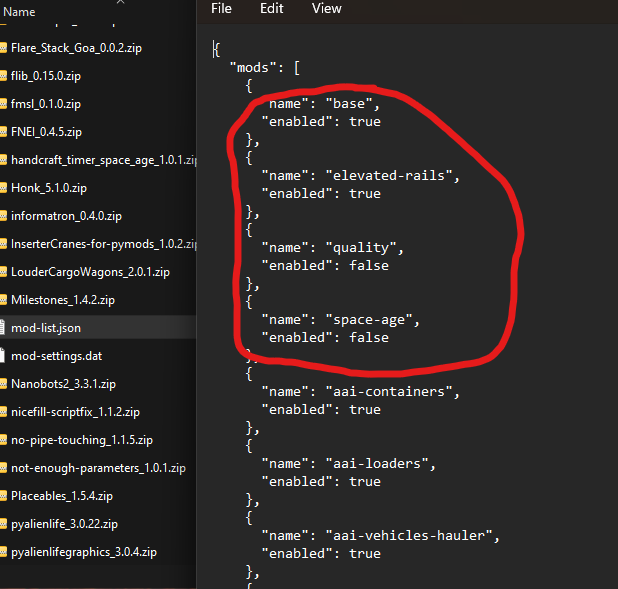

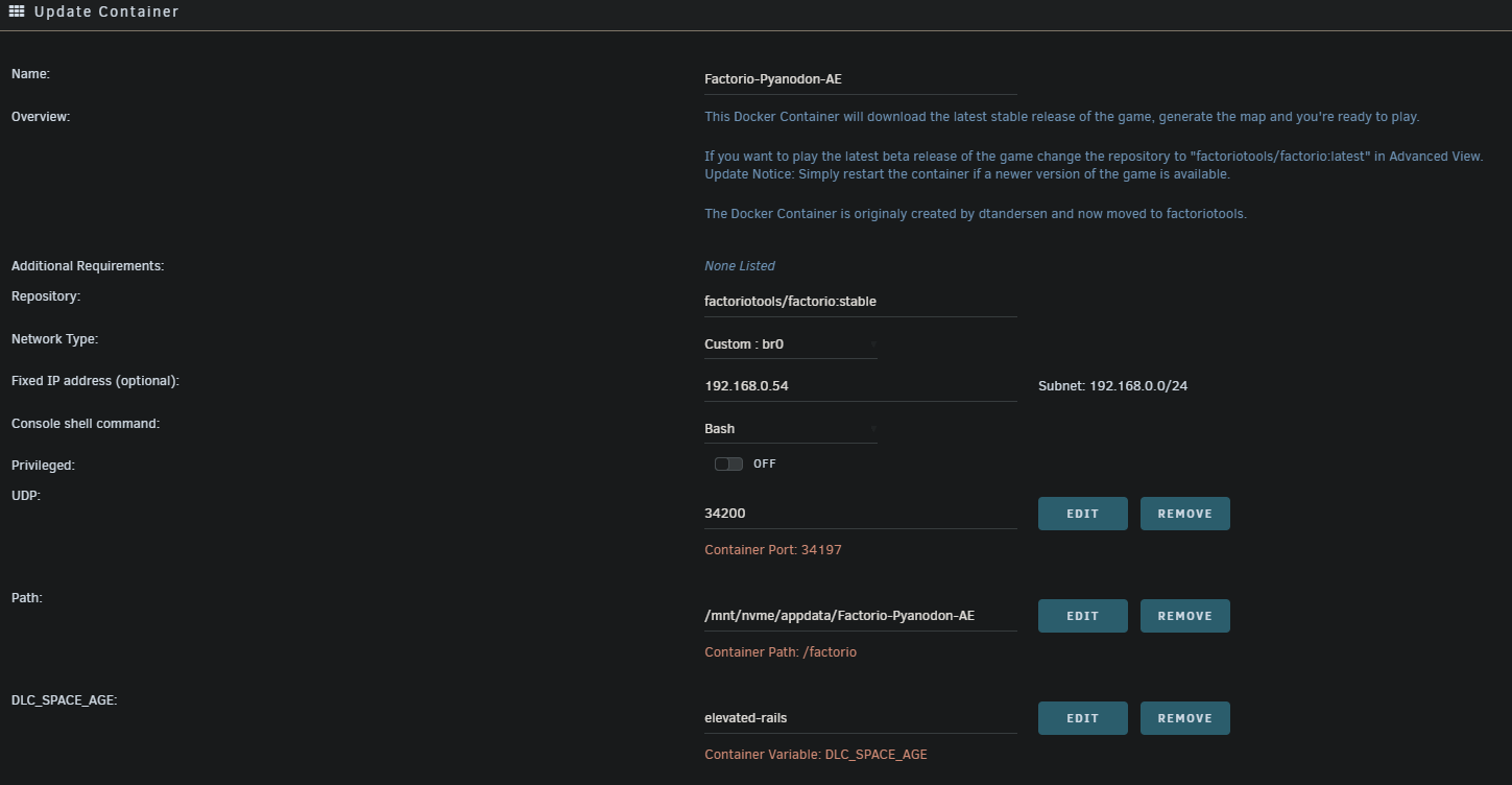

  4. Strange. I think I needed to make a fresh container for is to work iirc, but here are some screenshots if it helps. I do know if you misspell the dlc name or put it in quotes it won't work correctly and resets the modlist, so make sure no typos or quotes
  5. I spent so much time trying to figure this out too, but the factoriotools image added support for it. You need to add this variable DLC_SPACE_AGE and the value as needed ("true" for all 3 mods, "false" i'm assuming this will disable all 3?, or the mod name(s) you want such as "quality" "elevated-rails" "space-age" see here: https://github.com/factoriotools/factorio-docker?tab=readme-ov-file#user-content-fn-1-336ed1ee92ba76bc64b4913eba6e5f05 "Space Age mods can also be individually enabled by using their name separated by space. Example 1: Enable all by using true Example 2: Enable all by listing the mod names space-age elevated-rails quality Example 3: Enable only Elevated rails elevated-rails ↩"
