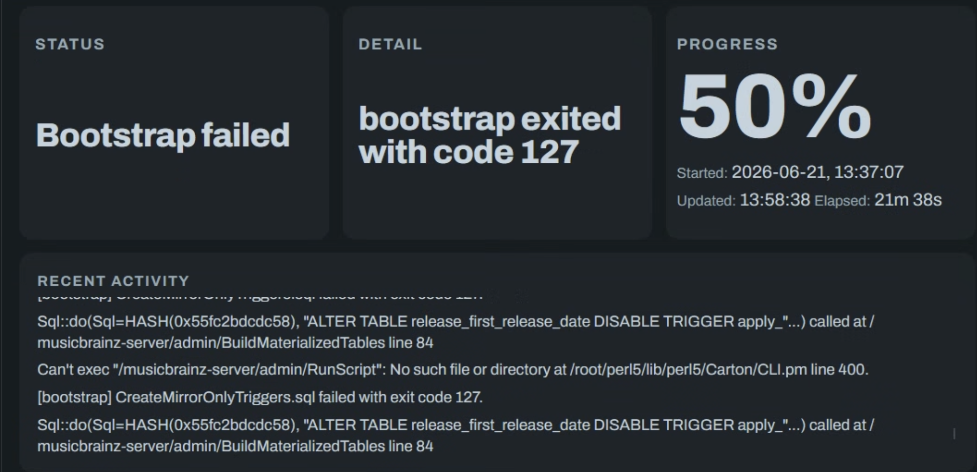

  2. I just can't get this to work for some reason. Currently I'm getting a "bootstrap exited with code 126" at 1% and this is the recent activity that's shown: /usr/local/bin/docker-entrypoint.sh: line 25: /limbo/deploy-admin/run-unless-postgres18-migration-required: Permission denied
  3. Any updates to resolve this Bootstrap issue? I'm excited to get this working :-)
  4. I'm installing using Composer Plus, and while downloading I get an Error Code 127. I'm not sure how to get past this?
