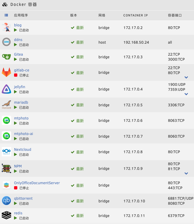

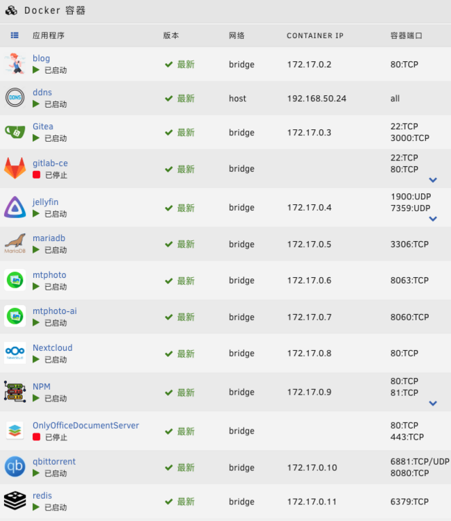

  1. After upgrading to rc2, Docker is unable to upgrade containers, which worked fine before. After clicking the upgrade button, a request is sent every 10 seconds, but there is no change on the Web UI. Is this a bug? Additionally, do I need to provide any other log information? tower-diagnostics-20241230-0915.zip
