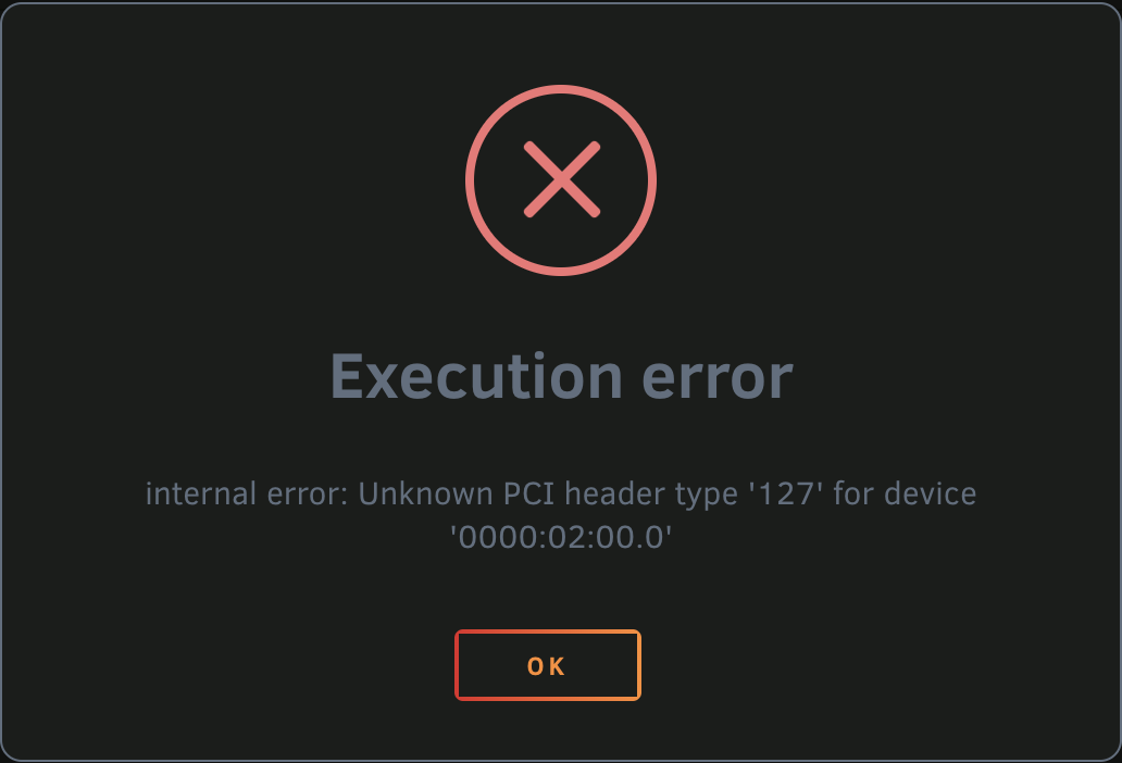

  1. Options like "Above 4GB MMIO BIOS Assignment" and "Re-Size BAR Support" already enabled. Bios has the latest version. I've tried swapping cards, but no change. And I'm sure there's about 70W on that PCIe. And one more thing, I cannot change EFI to Legacy, there are only two options: "EFI" and "Disabled"

  5. @WingmanNZ, hello! I have a same build with x13sae-f + intel 12700. Did you try to start in legacy mode? I want to passthrough my gtx 1660 to vm but it is unsuccessful and I dont see any option in bios.

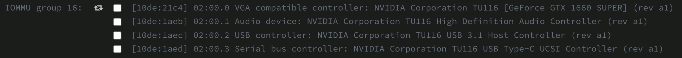

  8. Hi everyone. I apologize for the question, I know it has been raised many times, but I could not find an answer ๐Ÿ˜ž I build a server and trying to set up a gtx 1660 super to work with a plex. I installed the drivers, the card was not recognized, removed and reinstalled - the same result. Please, help. Screenshots and logs are attached. The card is recognized in unraid brainserver-diagnostics-20221221-1916.zip
