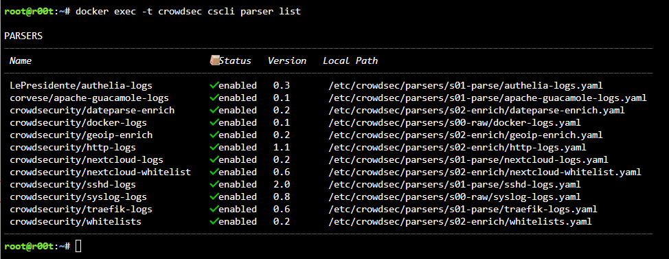

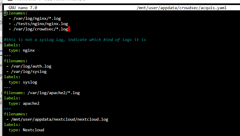

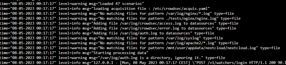

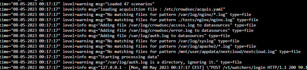

  6. hi there, i have the same problem with "No matching files for pattern". I can manually block my IP and unblock it, so I guess crowdsec is working correct. But it seems like my nextcloud logs won't be read! Nextcloud-Parser seems to be active: But nextcloud logs aren't displayer here: And in cli it says: So I guess nextcloud logfile won't be read? this is my acquis.yaml: My questsions are: 1. how can I check nextcloud.log with crowdsec? 2. how can I verify for sure, that crowdsec is working on nextcloud? 3. how can I test a malicious string or something on my nextcloud to see if my IP-Adress is getting banned through crowdsec? Thanks for help ::: EDIT: OK, I've found it out myself You have to create a path variable on nextcloud docker and crowdsec docker: Then you have to tell nextcloud to change the logfile path: sudo -u abc touch /log/nextcloud.log chmod 777 /log/nextcloud.log Then Edit the config.php and insert the path: nano /mnt/user/appdata/nextcloud/www/nextcloud/config/config.php 'loglevel' => 1, 'logfile' => '/log/nextcloud.log', ::: Now I have another question How can we test if crowdsec is doing something at all? As far as I know, crowdsec can only prevent bruteforce for nextcloud (which is too bad, I was hoping, that crowdsec is a real intrusion prevention system and blocks more attack szenarios like "trying SQL Injections".... nethertheless I now have the problem, that I can't test crowdsec for bruteforce attacks since nextcloud anti-bruteforce tool is blocking my tests BEFORE crowdsec is blocking anything. Does anybody have an idea on how to test if crowdsec is doing its job? How can I trigger a pattern to verify?

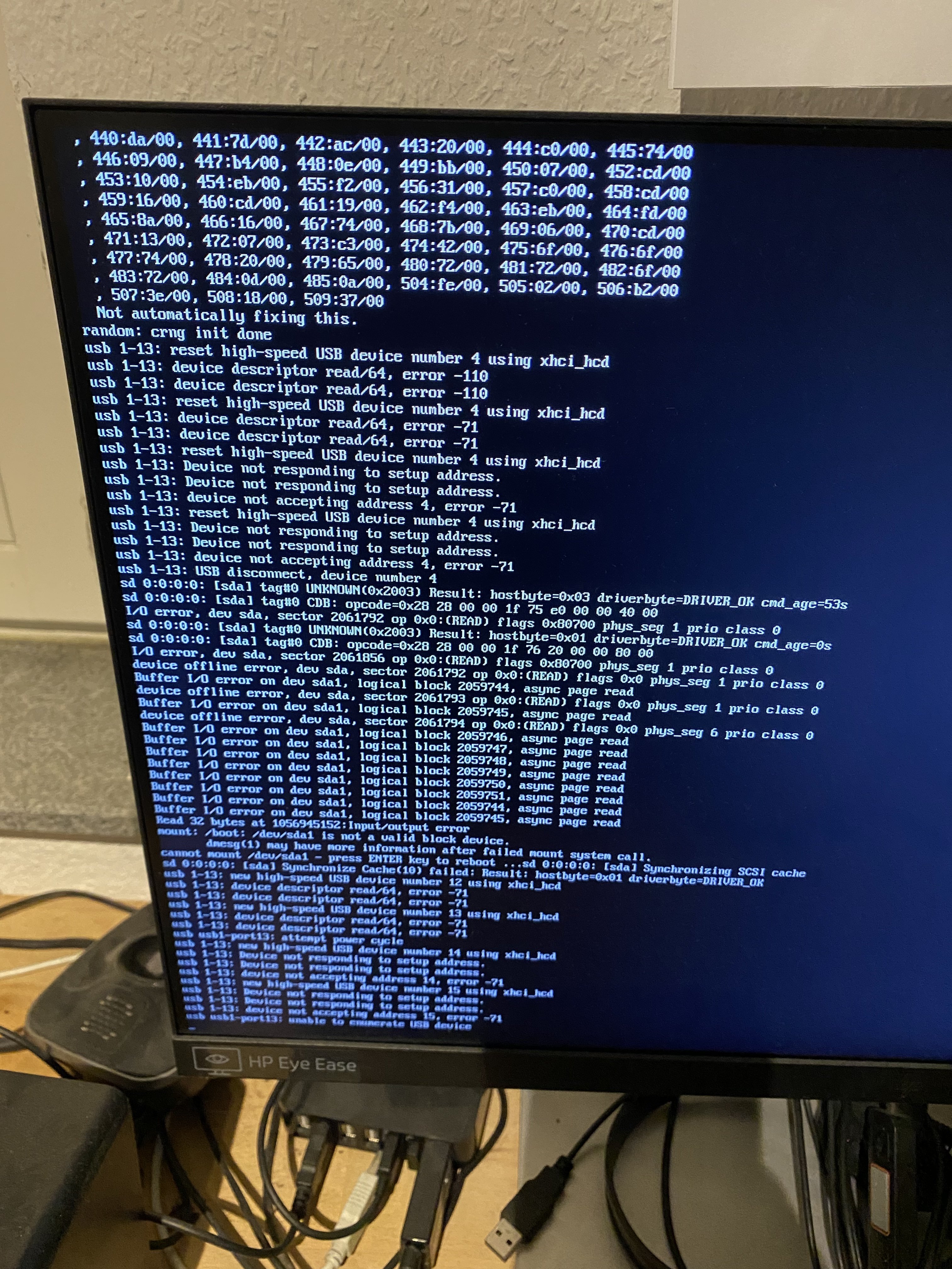

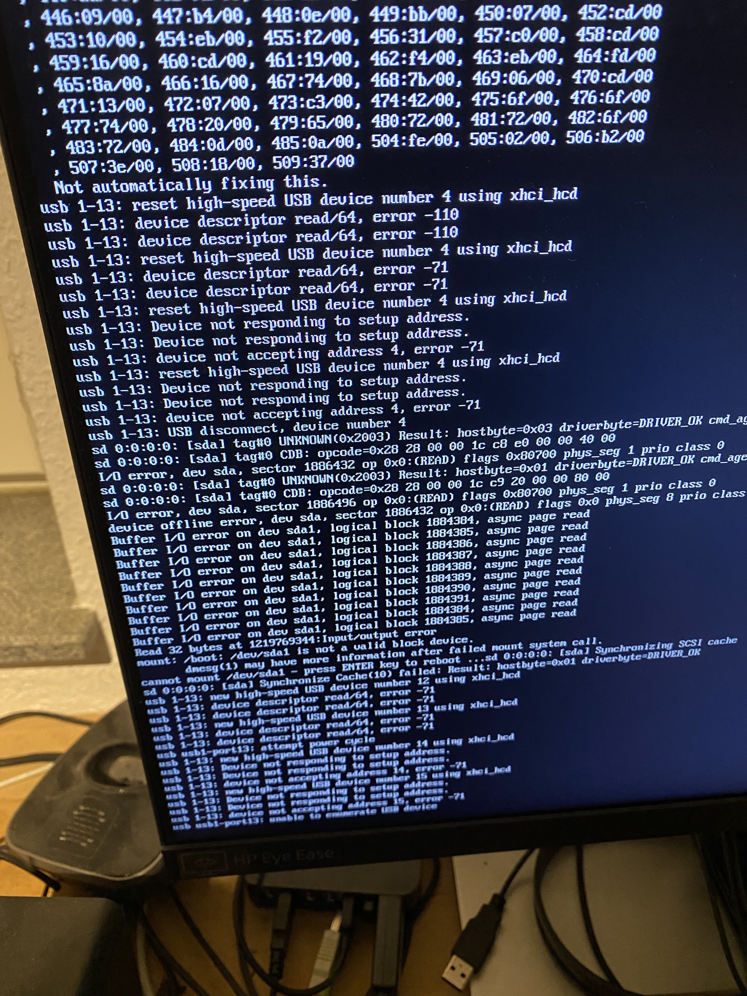

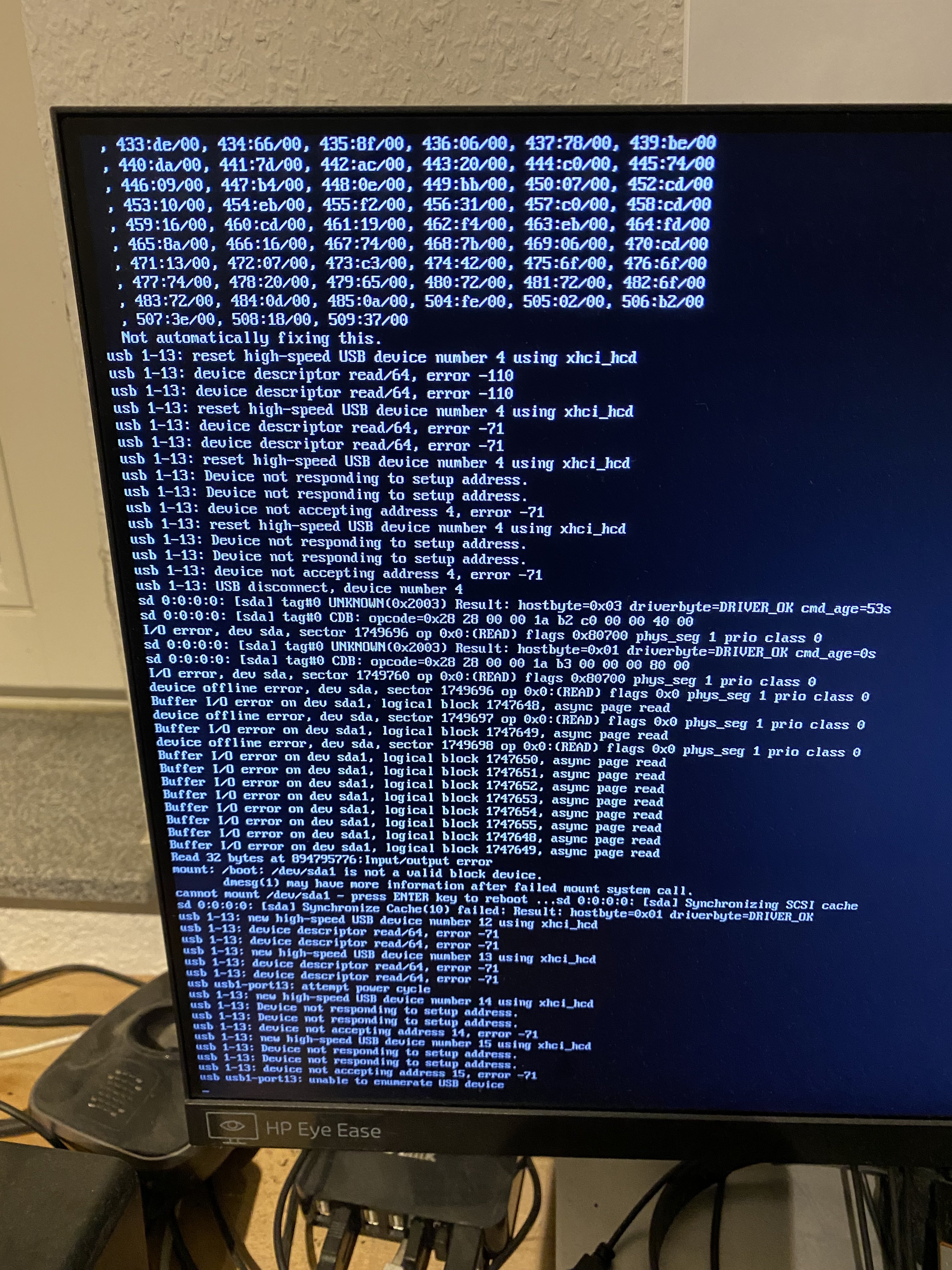

  7. after I switched to another usb-hub and had the same issue, i replaced my usb stick. Now I can say: my usb stick was dying On my new usb stick, I can reboot over 10 times in a row without a single issue. Thanks for your help!
  8. Thanks for this hint! When I unplug every USB except the unraid USB, I can boot 5 times in a row without any issues. I then pluged the USB-Hub back in which has my USB mouse and USB Keyboard and then the boot-problems happened again. I will buy another USB-Hub and try again.
  9. It is a USB2 Port for the boot drive. (Front USB) I have attached a USB-Hub to another Rear USB which is passed through to the Win10 VM. Do you have any further ideas?
  10. thanks for your reply, I will read further on how to use the second network adapter on my unraid for different dockers and throw the second network adapter in a vlan.
  11. hi there, I have the problem (ever since), that my unraid usb stick is not recognized by my Server and it boots directly to windows. I updated bios to the latest version. After that, my server recognizes the usb stick every reboot, but every now and then it fails to boot properly. When I stick my usb stick to another USB Port, and reboot then it boots normal for a few times before it happens again. I have attached you pictures of the errors. Unraid stops booting. What I have done so far: 1. played around with legacy and UEFI boot 2. deactivated secure boot (for sure) 3. deactivated fast boot 4. bios update The model of my motherboard is TUF X299 MARK 1 I'm a UNRAID user and big fan since december 2022. My brand new usb stick which I bought on christmas had this problem ever since. Once the system has booted everything runs smooth for weeks! Do you have any suggestions to stop this? I would be very happy to solve this problem since my Nextcloud is not available after a powerloss and that's a big problem when I need it and I am not at home thanks!
