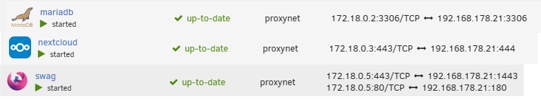

I have nextcloud running through swag like spaceinvador does in his tutorial.
SWAG and nextcloud can reach my internal network and my Windows10 Client directly on any port which is a security issue in my opinion.
Because if SWAG or Nextcloud docker gets hacked, then my whole system can get compromised.
So I want to block internal traffic between the dockers and isolate the proxynet completely. Is that possible?

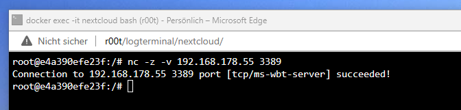

I have posted screenshots of my setup and a established connection from the nextcloud docker to RDP Port of my Win10 Client which i wan't to block with iptables.

Dont try and manipulate iptables manually, its complicated and not worth while in general (particularly because docker uses iptables and doesnt play nice with user defined stuff). You can achieve better isolation using docker's networking capabilities, however you will not be able to do so using unRAIDs web interface as it does not support setting up more complex network layouts. You will either have to use something like compose, portainer, or docker cli commands.
What you likely want to do is put is put the nextcloud and mariadb containers on a separate internal docker bridge network with no port mappings. Then your swag container would connect to both your proxynet network and the network that the other containers are on.

So if there is an exploit on nextcloud itself which leads to a rootshell on the docker container "nextcloud", someone could install for example metasploit on that container and can try to attack my Win10 Client in my home network (since it is pingable and connectable).
That's a thing I can't get out of my head and I really don't like :(
Attacker attacks --> https://nextcloud.OWNSERVER --> runs an exploit to gain access to a root shell on nextcloud docker --> install "hacking tools" on nextcloud docker --> attacks my Win10 VM and hacks to RDP Port (which I assume is open in that scenario)
