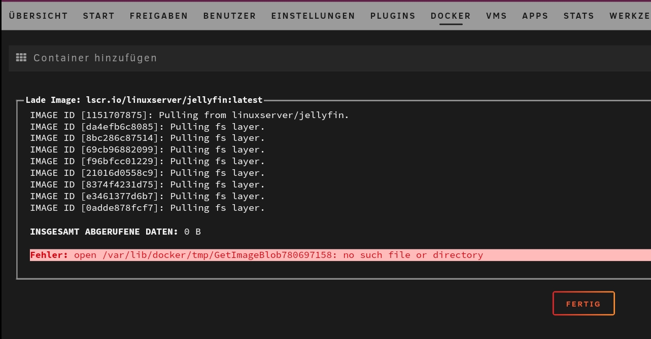

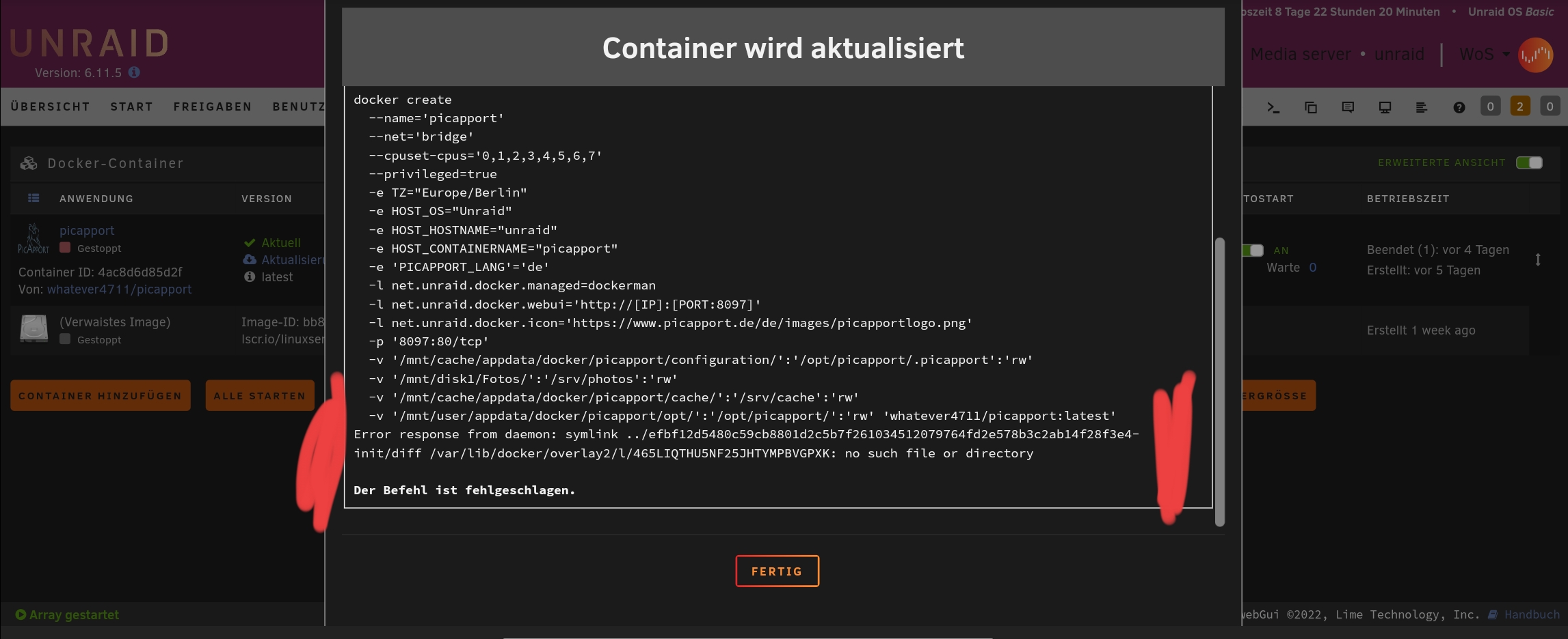

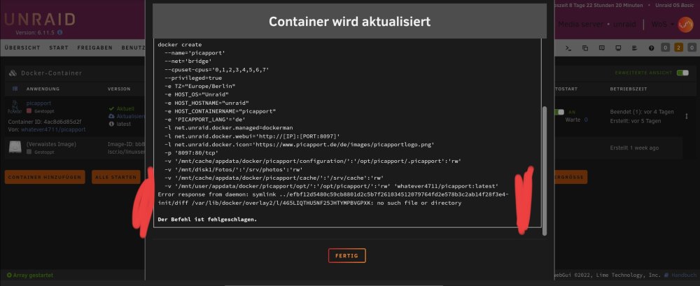

  4. Only two Containers running in docker since last docker-crash to test. Today i woke up the server to check the funktionalität of the containers and they crashed again. I pushed the update to each container but this ends in an error "No such file or directory" 🥺 (Screenshot) I added the diagnostic file again. Hope someone can support me? @jbrown705: Are your docker containers running? Thank you and greetings WoS unraid-diagnostics-20230817-2028.zip

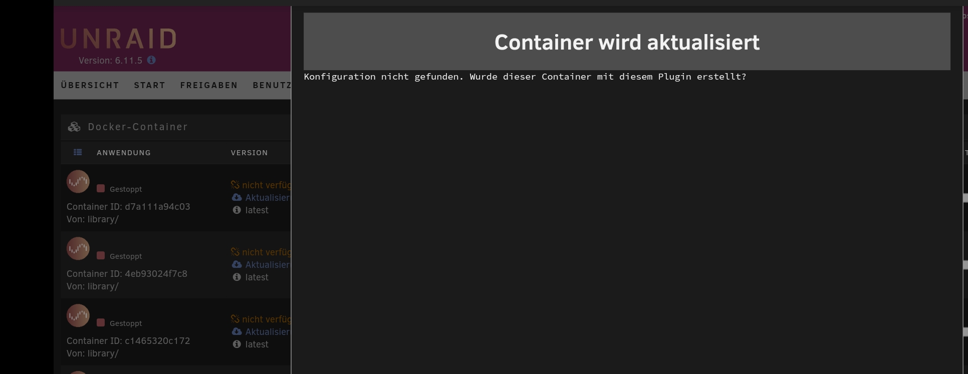

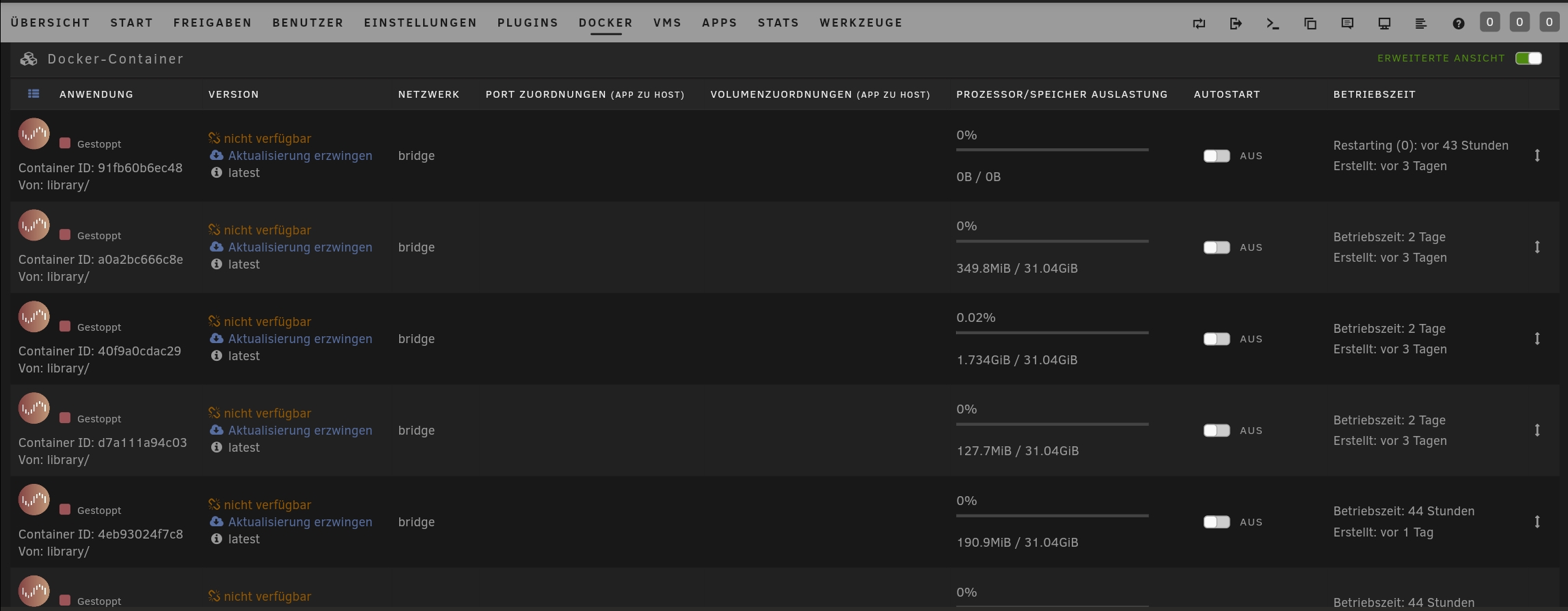

  6. Hello @jbrown705, i have problems with my docker Containers too. With 6.11.5 it works great for months but after upgrading to 6.12.2 and then 6.12.3, all Containers crashes after some hours. I deleted the Containers and added them from my Templates. It worked for many hours and then the same... All Containers broken. Downgrade to 6.11.5 and all Containers with new Images. Worked for hours. The Problem is still the same now with broken Containers from 10.08.23 in the evening. I changed to IPVLAN before but nothing changed 🥺 Now i can't add the Containers from my Templates. I have to delete the docker folder again and then IT will work but i think that will BE only for hours again. @JorgeB Can you see Something in the diagnostic File that can Help me? Thank you and good luck @jbrown705. Greetings WoSunraid-diagnostics-20230812-1630.zip
