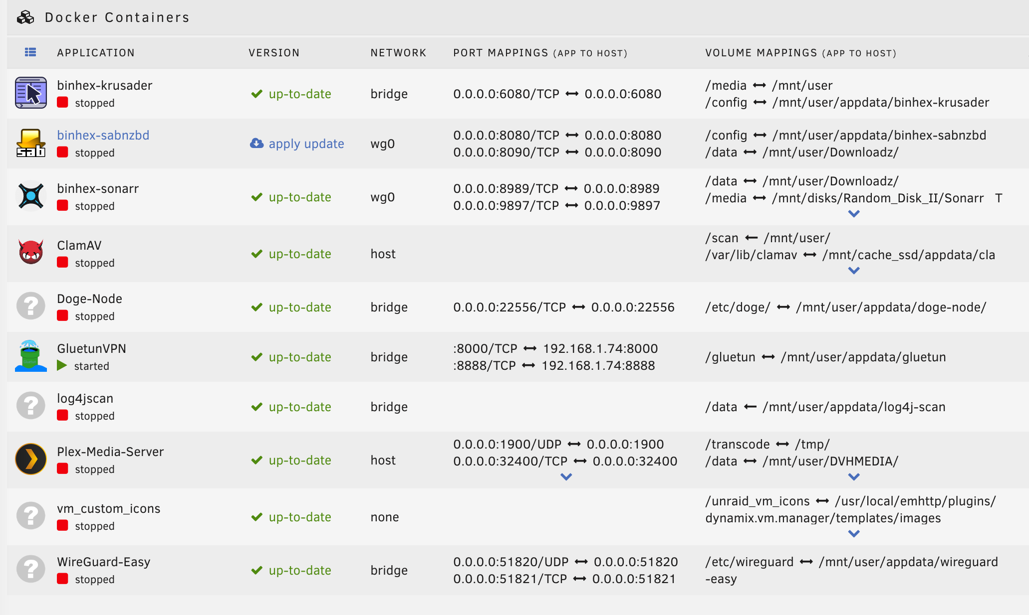

  1. No the Random_II was an external usb (unassigned) Yes. I remember the cache_ssd (not really configuring with purpose)
  2. I stopped plex because I didn't want it writing anything.

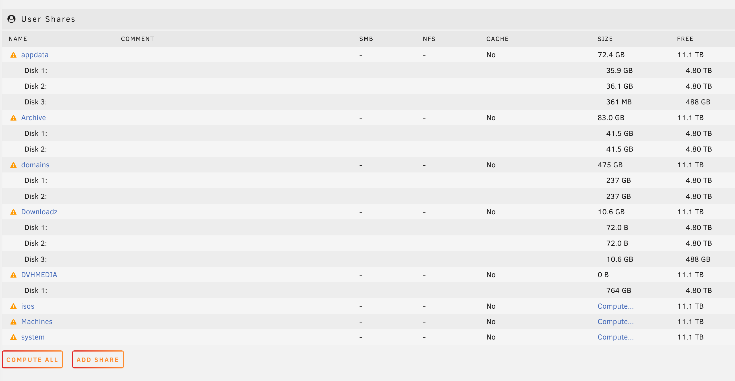

  3. the compute all is still computing. I believe I had a mirror and believe you to be correct (all foggy with all the stress) just not sure as to the specifics on how to best recreate. my array is still running. is this ok?
  4. I assure you I had parity, as it would run as scheduled with alert notifications. I am not sure what is going on. you can see both drives are exactly same with data. Should I shut the array off? I am afraid to install community applications and unassigned devices to see if I can get my original /boot/config that I believe I moved to it. Not really sure how to proceed at all.

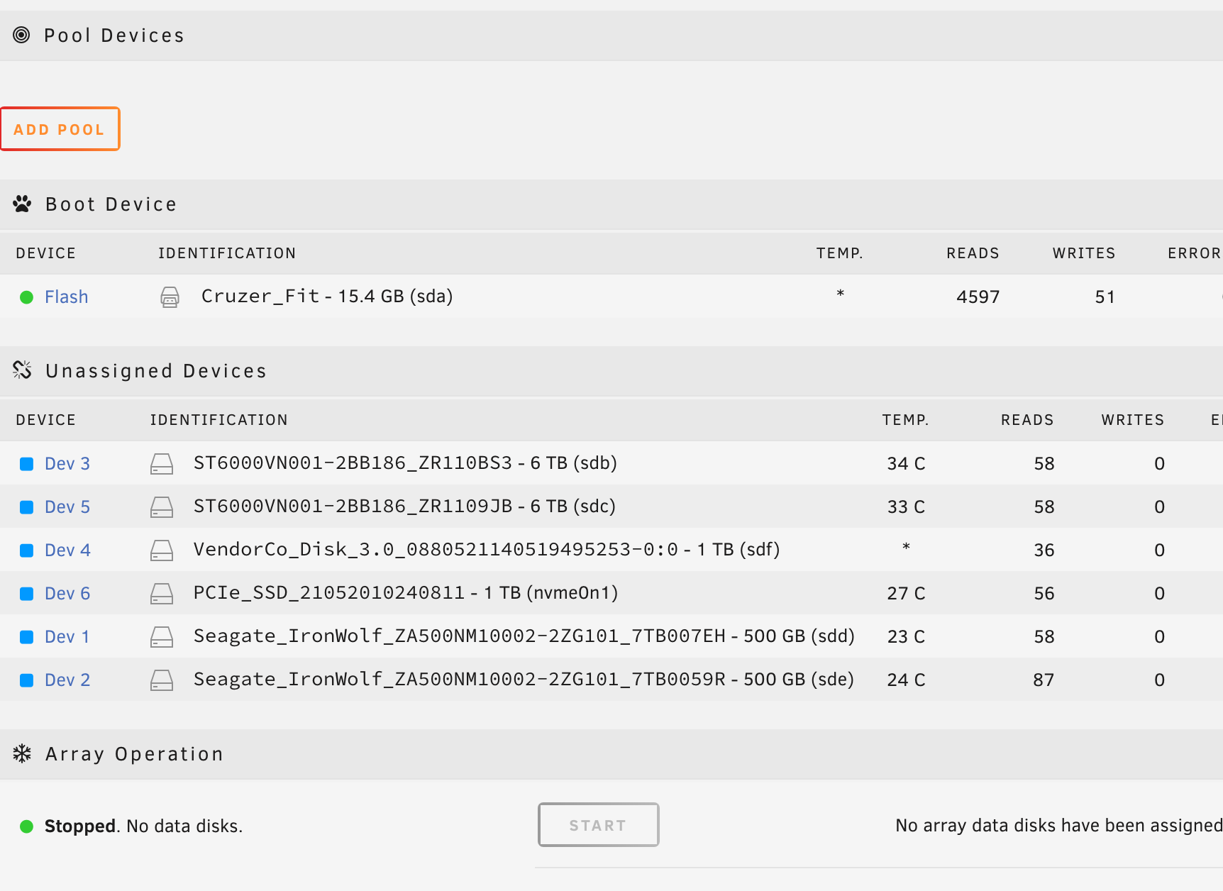

  6. I might have used it as a pool with the other 500. that makes sense to me. Yes I had parity drive for one of the 6TB. diagnostics is attached. tower-diagnostics-20230209-1410.zip
  7. if you have time please let me know your thoughts. tower-diagnostics-20230209-1410.zip
  8. I figured out that I have to create a new config after I start the array and its wrong. Any thoughts as to how to proceed? I suppose there is no way to understand pools and I will have to recreate shares? If I add one of the Seagates as parity it will erase it but I will keep the data from the other one?

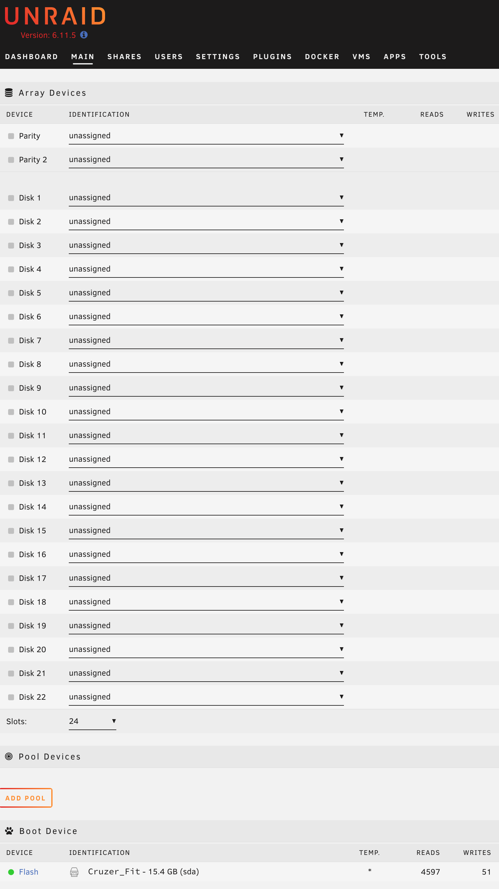

  9. I am very worried now as it only shows 1 as parity. The instructions says I was to create a new config but it only shows "preserve current assignments" was I supposed to do that or just assign the all drives as data as I have now done?
  10. when you say "assign" the devices are you saying to select "All" under the "Preserver Current Assignments"?
  11. this is what I see. I now have my license back and can proceed but a little nervous about making a mistake. Following the advice from here: https://wiki.unraid.net/Manual/Changing_The_Flash_Device#What_to_do_if_you_have_no_backup_and_do_not_know_your_disk_assignments: I am stuck as the instructions don't align. Should I select "All" for "Preserve Current Assignments"?
  12. there is no Tools -> New Config "create a new array configuration". Only "Preserve current assignments"
