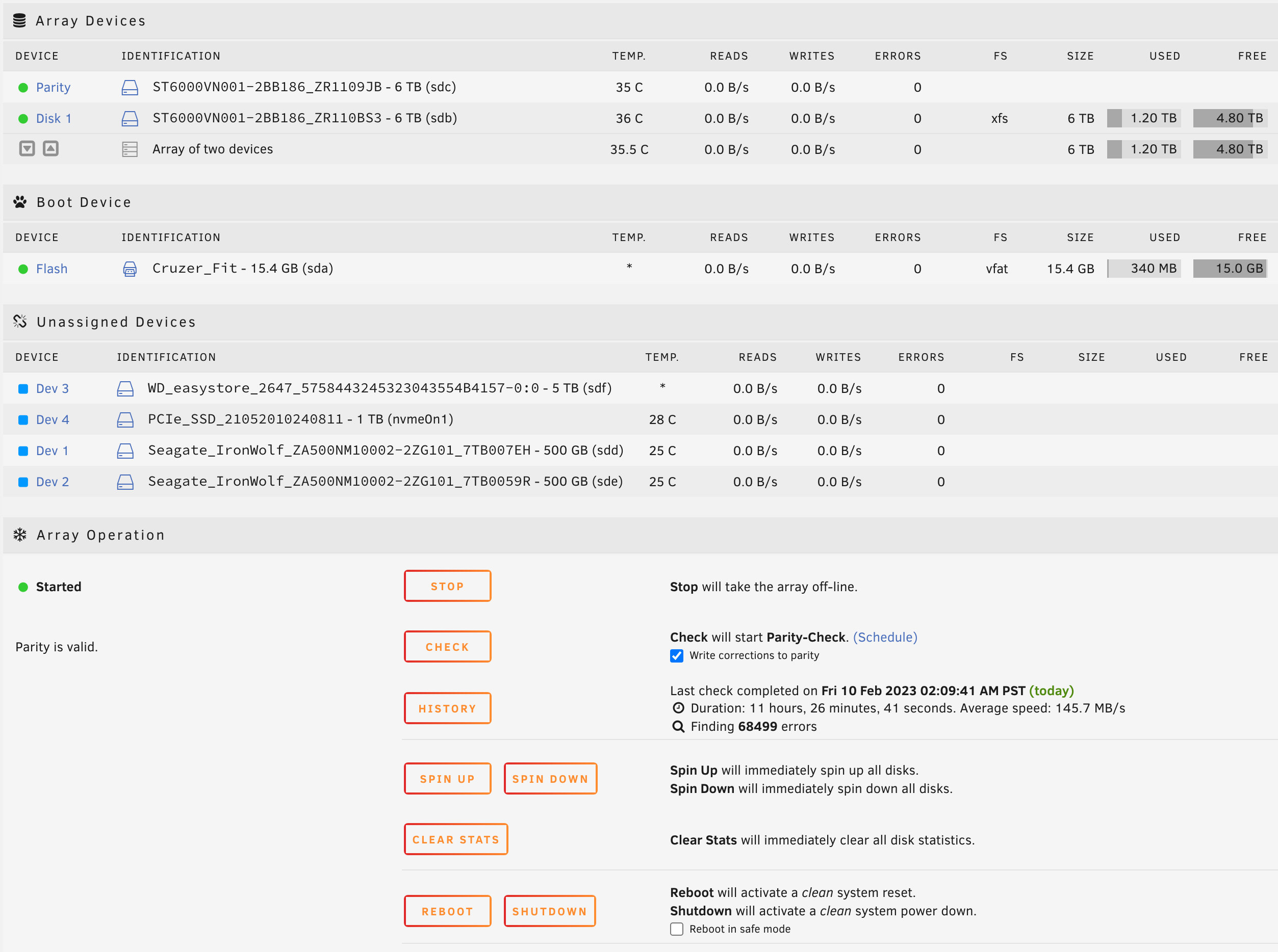

Accidentally ran rm on root and reformatted usb without config
All done. Everything seems like it was. one vm didn't require recreating/installing. I just added it and referenced the disk image and it was working where it left off. The others I had to readd with no issue. one question: On my pools do I need to add a minimum of 3 drives so one can act as a backup? Thank you again for all of your help. I won't post here anymore with questions off topic. very much appreciate it.
VMs are enabled but they still do not show. Parity Check completed with zero errors. Diagnostics are posted. I definitely think my issues stem from inproper use of cache / pool. tower-diagnostics-20230211-1141.zip
only thing I noticed is I lost my previous virtual machines but can live with that as I wasn't attached to them anyway. I can redo those. If there is a way to readd great but no loss otherwise. Started a new parity check.
BACK IN BUSINESS. HAHAH. Thank you Thank you. I have learned a lot in this little adventure. Couldn't have survived without you trurl. I have made another backup. Now I would love to evaluate my config to understand if there is a better method to the madness.

I was able to mount the drive that I moved all of my files too. Would it be easier to pull the config directory and make a new usb replacing with old config? Everything appears to be there.
I went ahead and added the other 500 to the cache_ssd pool because I honestly remember it that way and it appears it accepted both as the pool as shown. The other thing I am pretty sure I did was use the nvme as the parity 2. But I will wait for your thoughts.

if both 500 were originally a pool don't they both have to be added to make the pool? and that is why just one added is not mounting?

I have the menacing alert "all existing data will be overwritten when I start" for the parity (sdc)- Accidentally ran rm on root and reformatted usb without config
"spinner" meaning the other 6TB drive that was not assigned as data correct?- Accidentally ran rm on root and reformatted usb without config
done. tower-diagnostics-20230209-1609.zip- Accidentally ran rm on root and reformatted usb without config
I do not. my original thinking I believe was to pool the 2 500 and use nvme as parity. really wanting to run vms on ssd's with backup protection. I suppose I didn't achieve that. As far as pools I only remember the cache_ssd. - Accidentally ran rm on root and reformatted usb without config
