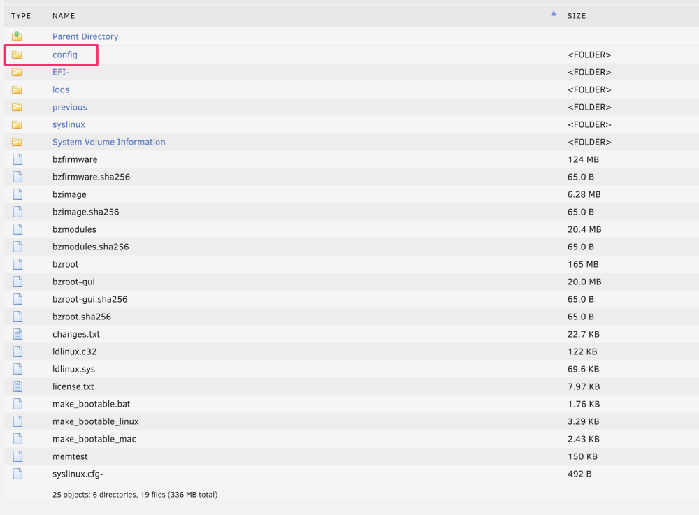

I moved them to a usb drive. I still have all of the files that I moved. just don't know how to get them back to their rightful place.
If you still have them all then your flash contents should be in /boot
so if I move all of those directories and files to the flash-drive/boot?
move everything from /boot to the top level of flash. There should be a lot of bz* files in the top level, with some subfolders below that, including config (your configuration)
