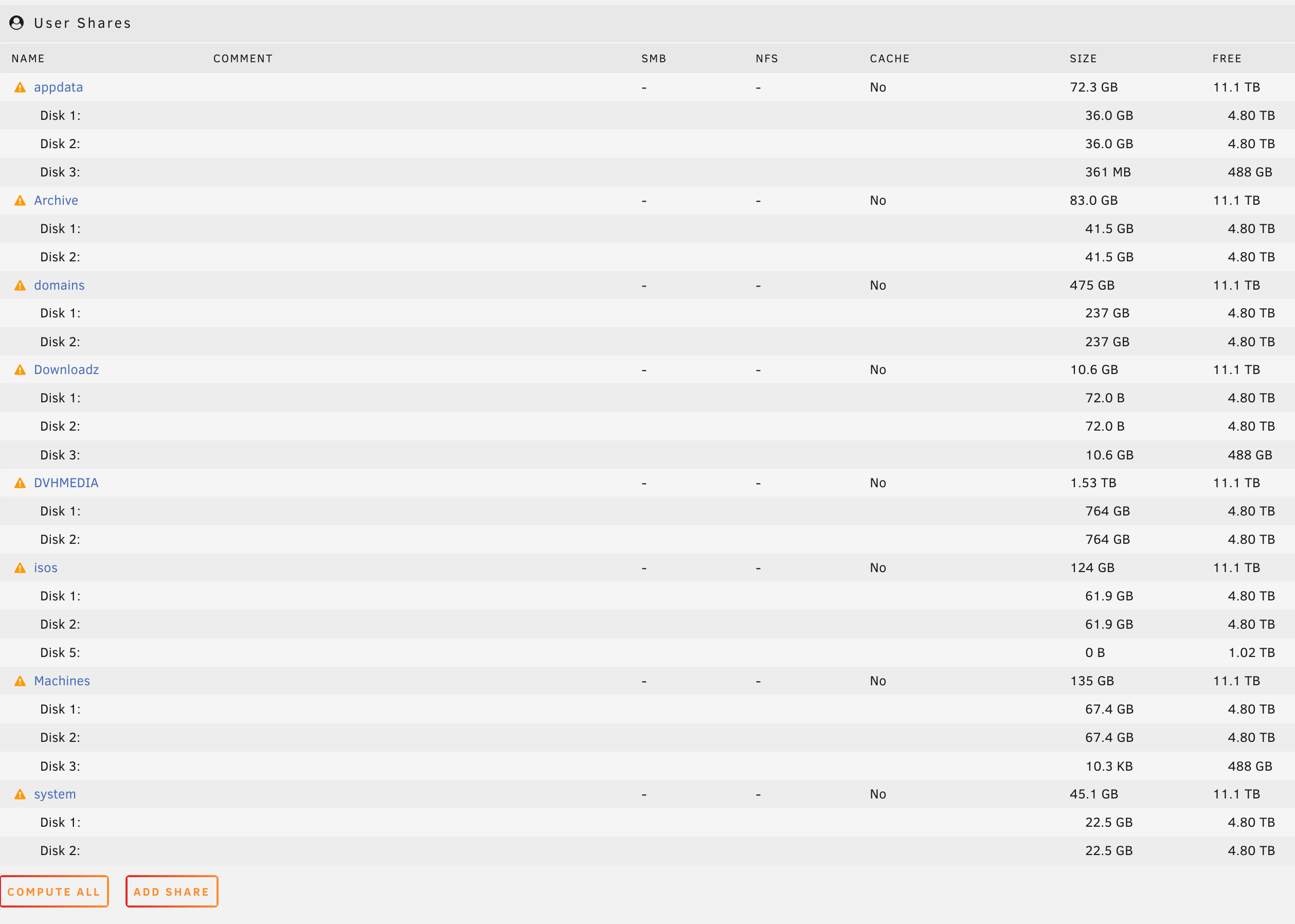

2 minutes ago, trurl said:
Looks like disk2 has a little more appdata than disk1, probably because docker is enabled. Might be a good idea to wait on getting parity assigned until we can get appdata off those disks and onto a pool where it should have been to begin with. domains and system should be on a pool too.
Still need to see the Compute... for those last 3 shares, especially system.

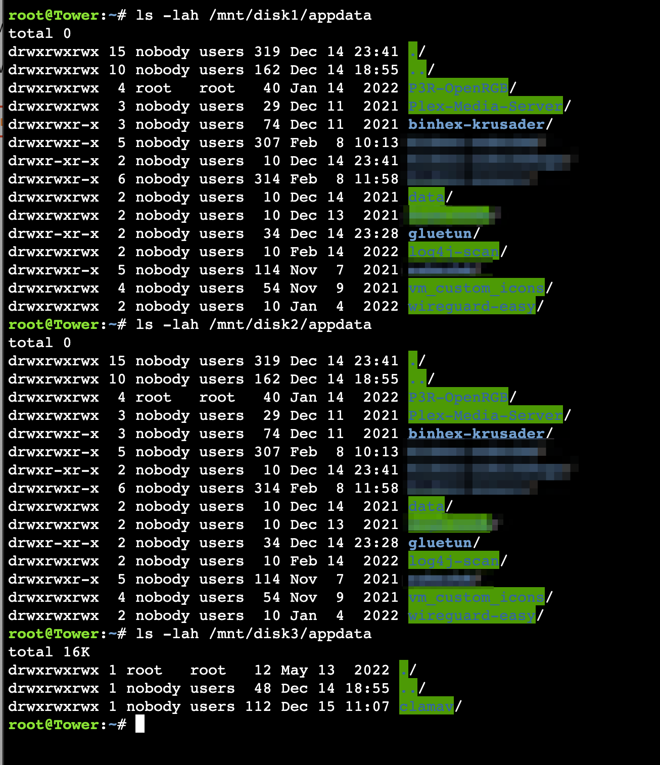

What do you get from command line with this?
ls -lah /mnt/disk1/appdata
and this?
ls -lah /mnt/disk2/appdata
and this?
ls -lah /mnt/disk3/appdata
21 hours ago, trurl said:
Now that we have seen Docker page, disable Docker and VM Manager in Settings.
Looks like appdata is the only thing a little off as far as mirroring.
and this?
and this?

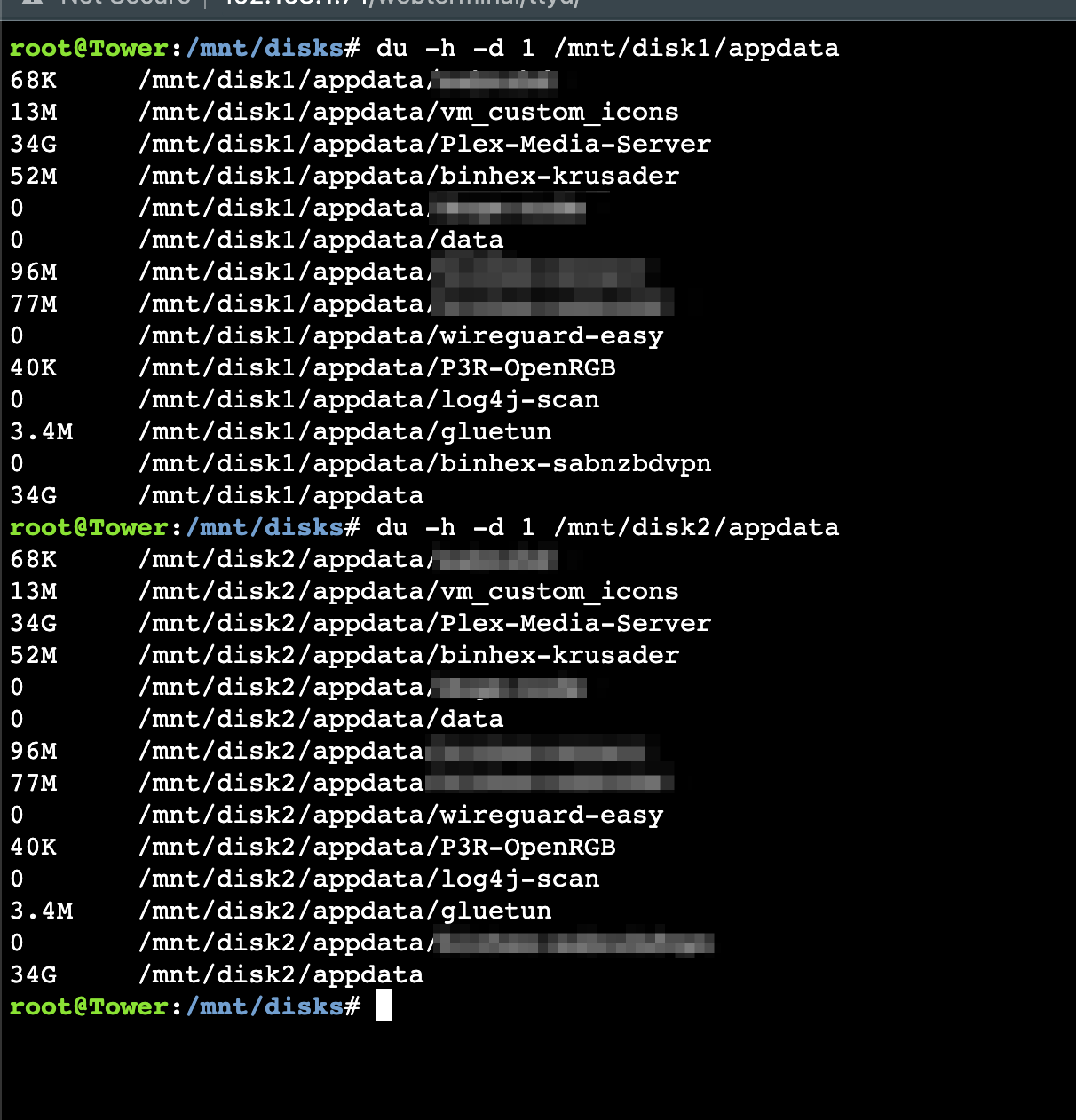

du -h -d 1 /mnt/disk1/appdata
and this?
du -h -d 1 /mnt/disk2/appdata
and this?
Edited by can4d

The latest User Shares Compute screenshot shows disk1 and disk2 appdata equal, and that agrees with the du results. Not sure why that earlier screenshot had slightly less on disk1.

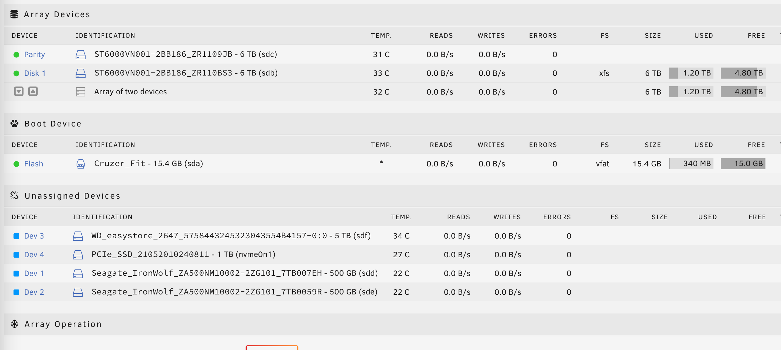

OK. New Config, assign other spinner as parity. Check parity valid box then start the array. Parity will probably be slightly out-of-sync so do a correcting parity check. That will also be a good test of how well things are working. Will take a several hours.
Post new diagnostics if things don't seem to be working well. Should be no Errors in the Errors column on Main - Array Devices.
You can examine your user shares if you want, but don't do a lot of reading and no writing until parity check completes.
"spinner" meaning the other 6TB drive that was not assigned as data correct?
correct

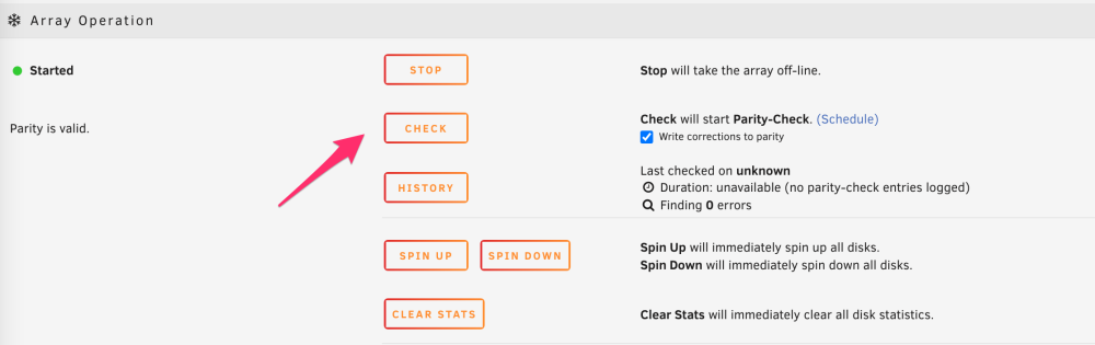

I have the menacing alert "all existing data will be overwritten when I start" for the parity (sdc)
done.

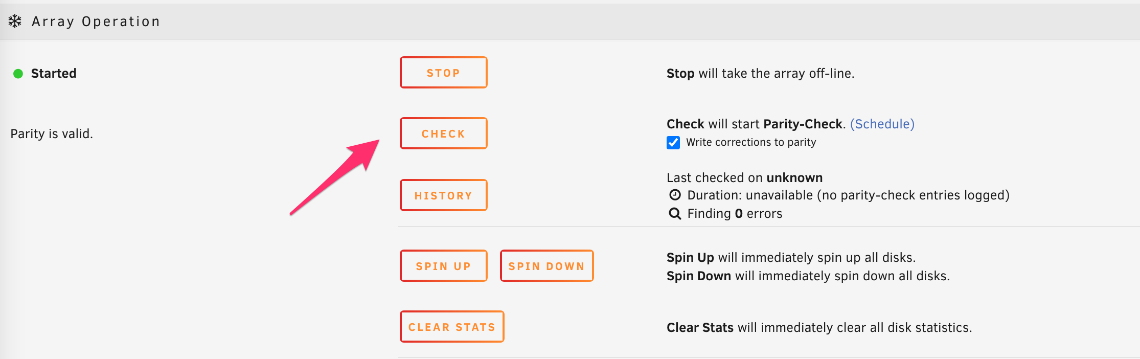

If you hadn't clipped Array Operations off that screenshot I wouldn't have to ask.
Are you running correcting parity check now?
not yet. I thought it did it since everything was green. So I click the check now?
yes
running now. roughly .2%. estimated completion of 8 hours. ugh.
