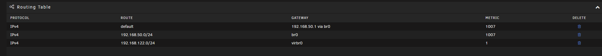

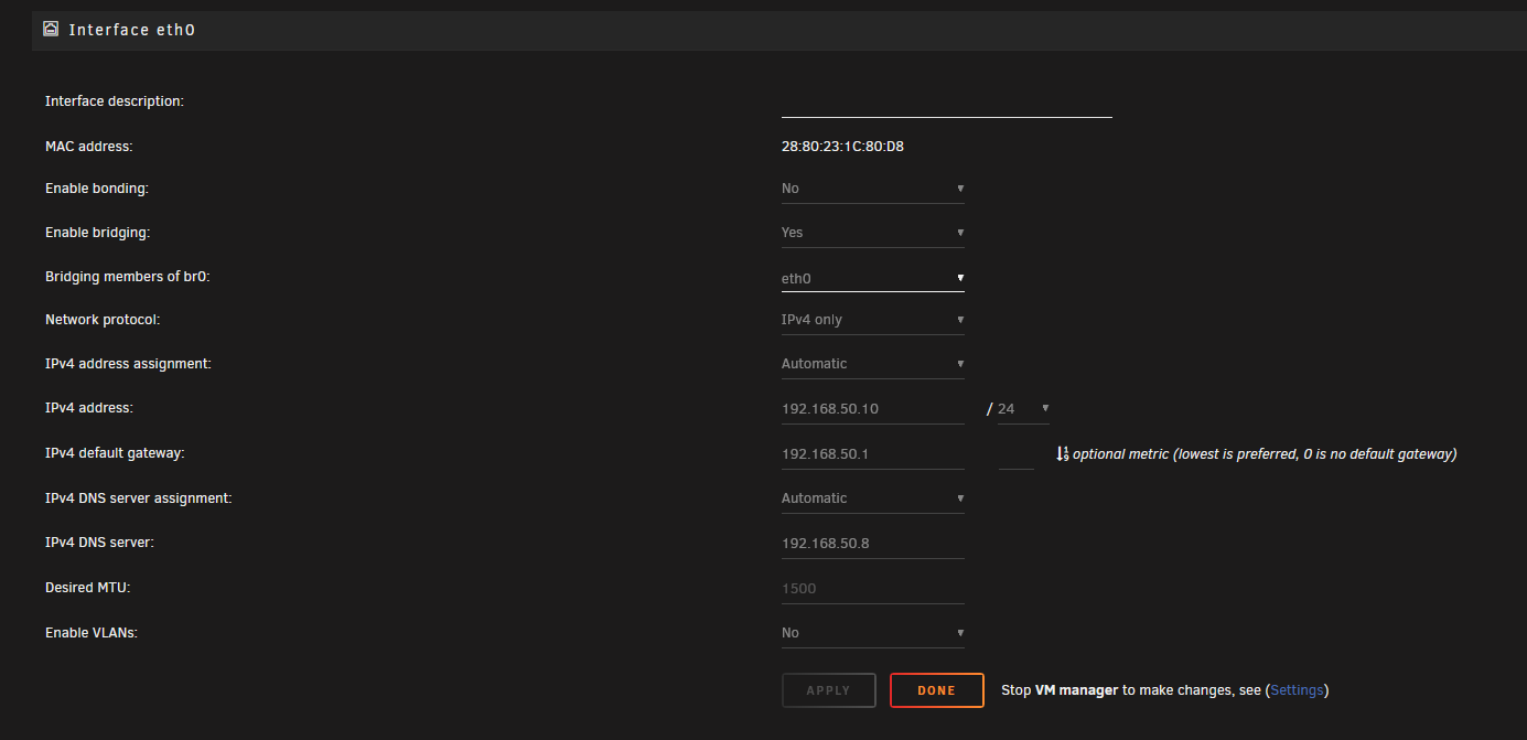

  5. Found the issue! It was caused by permanent ARP entry on my Opnsense router's ARP table that had an outdated MAC and seemed to be readded by the old DHCP server I used to use on there. Not a problem with unRAID at all!
  6. ocean_breeze changed their profile photo
