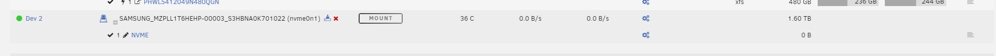

  7. I'm having an issue with an nvme drive where it is not mountable. I cleared this drive using UD, then formatted as XFS but it still shows unmountable. I checked that it doesn't have the "Passed-through" toggle switch enabled as I saw that caused this for someone else. Does anyone have any suggestions?
