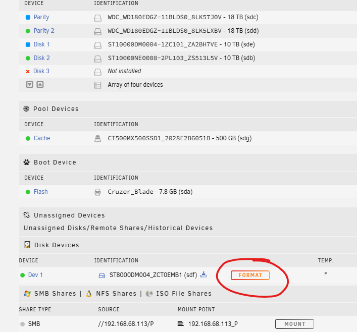

  16. I try and click on what I circled in red, and it says error see system log. Currently im in the process of swapping parity drives so that both my parity drives are the 18TB, and then Disk 1 (which used to be a parity drive) is back into the disk array (Disk 1).
  17. Hi @JorgeB Thank you for this, this led me into looking at 3.3V issues with the drives I used (Western Digital) which have an additional 3.3V. I've resolved this so that both by new WD drives are now detected. Now I have 5 drives back online. It was the 8tb that originally was causing me issues. I was going to add new drives to replace this, but given they were larger than my parity, I wanted to swap out the parity drive. I first added a 2nd party drive which successfully was added (i.e I now have 2 parity drives). So in my array, I have Parity (original) and Parity 2. Under disks, I have Disk 2 online, and disk 1 and 3 missing. I have one brand new WD drive which I can easily add. But the existing 8tb drive, that I have now brought online, when I try to format it gives me an error. Attached are the logs, it is Dev 1 - sdf if this helps. I cannot get it to format to try and add it to the disk array. mtower-diagnostics-20241205-1214.zip

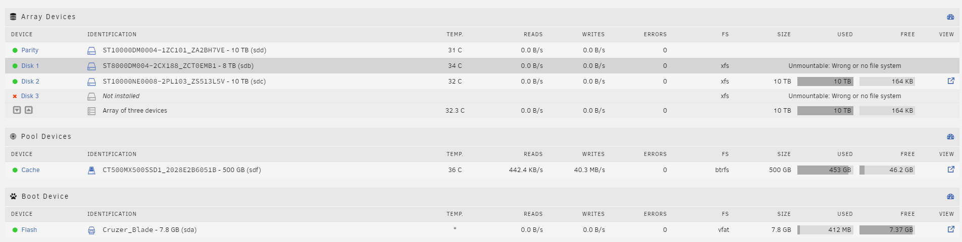

  19. Yes just bought a spare. I took the array offline, ensured Disk 3 said unassigned, and then took the array back online. The photo is what my Main tab looks like and then I ran diagnostics again. mtower-diagnostics-20240329-0852.zip

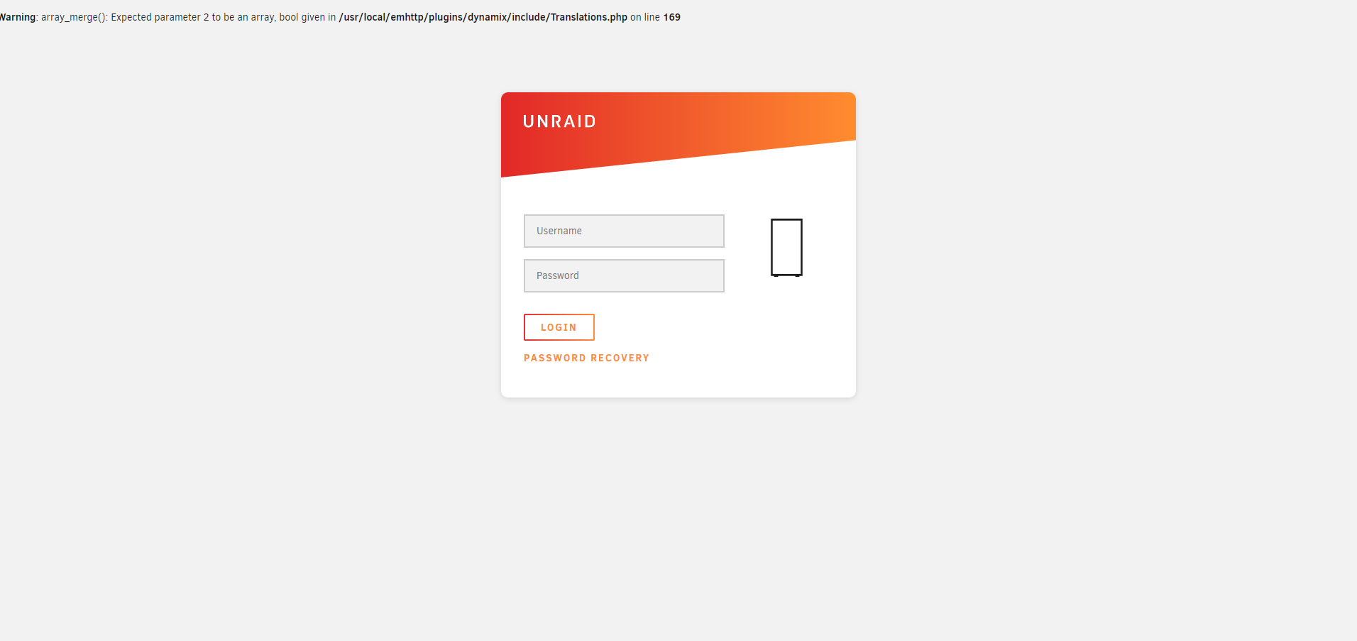

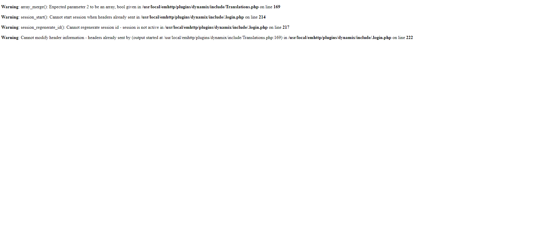

  23. Hi Team, A few days ago we had a power outtage, and although I had a battery backup, seems the backup also has failed for whatever reason, and how I cannot log into my server. I did notice at one point a hard drive had died, and was waiting to order a replacement but now I can't even login. This is the screen I'm getting (see attached). At this point unless I can log in and replace the hard drive and all that, what would be the best way to repair? First screen shot is the log in screen, second is when I try and log in.
