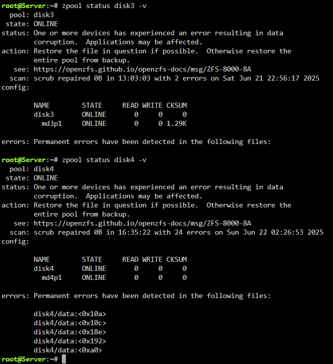

again. sorry for such a late reply. didnt have much time to do memtest, and since EVERYTHING else was working fine on my server i kept using it normally. so now i got time for that and ran memtest for about 17-ish hours. no errors. ram is fine. i did two separate 3-hour runs (4 passes) and then another longer with more passes that i waited for for about 10ish hours. so what is my next step now? how do i make the files re-appear inside the movies folder? or what do i even do to fix the issue of those random zpool errors.- Folder inside share empty, but files accessible from disks. Also random damaged files on two disks.
what if i do parity check? maybe it can fix something? (but i only have one parity drive and two of the drives have those zpool errors) btw i already tried scrub and i thought it fixed the errors, but neither the movies folder has re-appeared nor the errors have disappeared completely (they were gone for a few hours and then i still got the errors)- Folder inside share empty, but files accessible from disks. Also random damaged files on two disks.

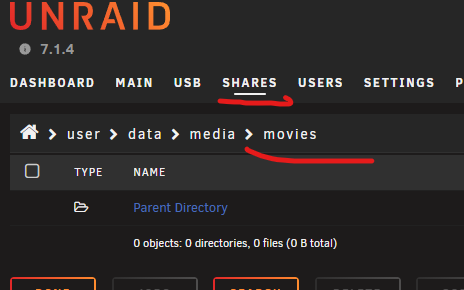

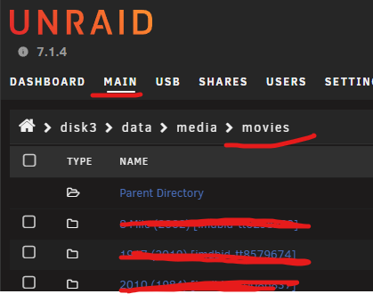

Hello, everyone. This may be somewhat long and unfocused post, but i dont even know where to start diagnosing or what to post here, so i'll just ramble about the problem that I have. I actually have two problems and I dont know whether they are related or not. First and the most major problem is that one folder in one of my shares is showing up as empty, even though it is not. I have "data" share that uses all of my disks and it has multiple folders inside. All of those folders are accessible except one. If I open shares>data>media>movies it is empty: but if I open any disk>data>media>movies then i can see the files inside. All of those files are accessible and openable. Second problem that I have is that there are bunch of damaged/corrupted files and checksum errors on two of my disks (disk3 and disk4): I asked around in discord server and people suggested doing zpool scrub and clear but all in vain. The problem still persists. So i need to confirm if these two drives are dead/dying or not. They already had some problems couple months ago, but i thought that was due to sata adapters that i had and so i took them out and reformatted and thought it was fixed. But now that these random errors resurfaced i think these two disks may be dying, but need a way to confirm that. And if these two disks are dying then maybe i could manage to copy data before they finally die? my overall disk usage is about 50% so theoretically if anyone helps me confirm that my disk3 and disk4 are dead i could maybe manage to copy all the data across disk1,2,5 and just replace the 3 and 4. But first, I just need to fix the first big issue to access my movies share. Also of note, i have done memtest for about 6-7 hours with no issues (i am saying this, because some people in discord suggested it may be ram issue)- Possible two drive failure with one parity drive. "Unmountable: wrong or no file system". Need help.
