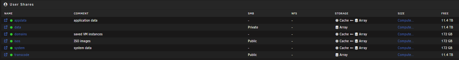

Thanks yet again @JorgeB every day is becoming a school day for me, with a great tutor. Really appreciate your help so far. Once the original cache data has been copied via mc to disk4\cache\... would I be correct in thinking that the steps are 1. Perform compare within mc to ensure as much is indentical 2. Deselect each of the current SSD from the cache pool 3. Restart the server 4. Configure a new cache pool having cleared the original contents of the existing SSD 5. Start array 6. Configure cache for /appdata /system /iso /domains to prefer cache and manually trigger mover 7. Once confident all data is on cache. (need to find these settings again) setup exclusive access to cache and unconfigure the mover setup? or am I totally over thinking/complicating this?

Finally grabbed some time to look at this. Oddly the plan was to copy the data from cache to disk3 which despite the "main" view indicating plenty of space free I almost immediately received the below error...repeatedly cp: error writing '/cache/cache/appdata/plex/Cache/PhotoTranscoder/55/55524ed89b9c4fbb35e82c1482d70681a003cfbc.jpg': No space left on device So created a new directory on Disk4 and attempted again. This time around a slightly different issue, which does look slightly odd, but might also explain the Plex database corruption and backup failure messages. cp: cannot stat '/mnt/cache/appdata/plex/Cache/PhotoTranscoder/ce/cea4dd8d5e6bf803a56eecfc9b23cf23'$'\230\021\372''Á'$'\210\377\377''.jpg': No such file or directory During which this was occurring I also lost access to the WebGUI, which does appear to be an intermittent fault Logs show Dec 2 11:35:42 Tower rc.diskinfo[20655]: PHP Warning: syntax error, unexpected end of file, expecting TC_DOLLAR_CURLY or TC_QUOTED_STRING or '"' in /var/local/emhttp/disks.ini on line 250 Dec 2 11:35:42 Tower rc.diskinfo[20655]: in /usr/local/emhttp/plugins/unassigned.devices.preclear/scripts/rc.diskinfo on line 294 Dec 2 11:35:42 Tower rc.diskinfo[20655]: PHP Exception: array_map(): Argument #2 ($array) must be of type array, bool given in /usr/local/emhttp/plugins/unassigned.devices.preclear/scripts/rc.diskinfo on line 295 Dec 2 11:38:52 Tower flash_backup: adding task: /usr/local/emhttp/plugins/dynamix.my.servers/scripts/UpdateFlashBackup update Dec 2 11:39:01 Tower crond[1518]: exit status 2 from user root /usr/local/emhttp/plugins/dynamix.system.stats/scripts/sa1 1 1 &> /dev/null Dec 2 11:39:30 Tower root: error: /plugins/unassigned.devices/UnassignedDevices.php: uninitialized csrf_token Dec 2 11:39:47 Tower monitor: Stop running nchan processes Which is making life awkward in regards to removing the existing pool and recreating it and of course moving the data back with mover. Any ideas @JorgeB

Thanks @JorgeB that's certainly reassuring. Can you see any configuration errors in how I'd configured the cache pool in a ZFS mirror/ Just wondering how best to recreate it once the data is relocated? Could I reverse the decision to switch to cache over array, have mover relocate and then delete, recreate the content etc, or would you suggest a totally separate location maybe a unassigned USB drive for instance?
