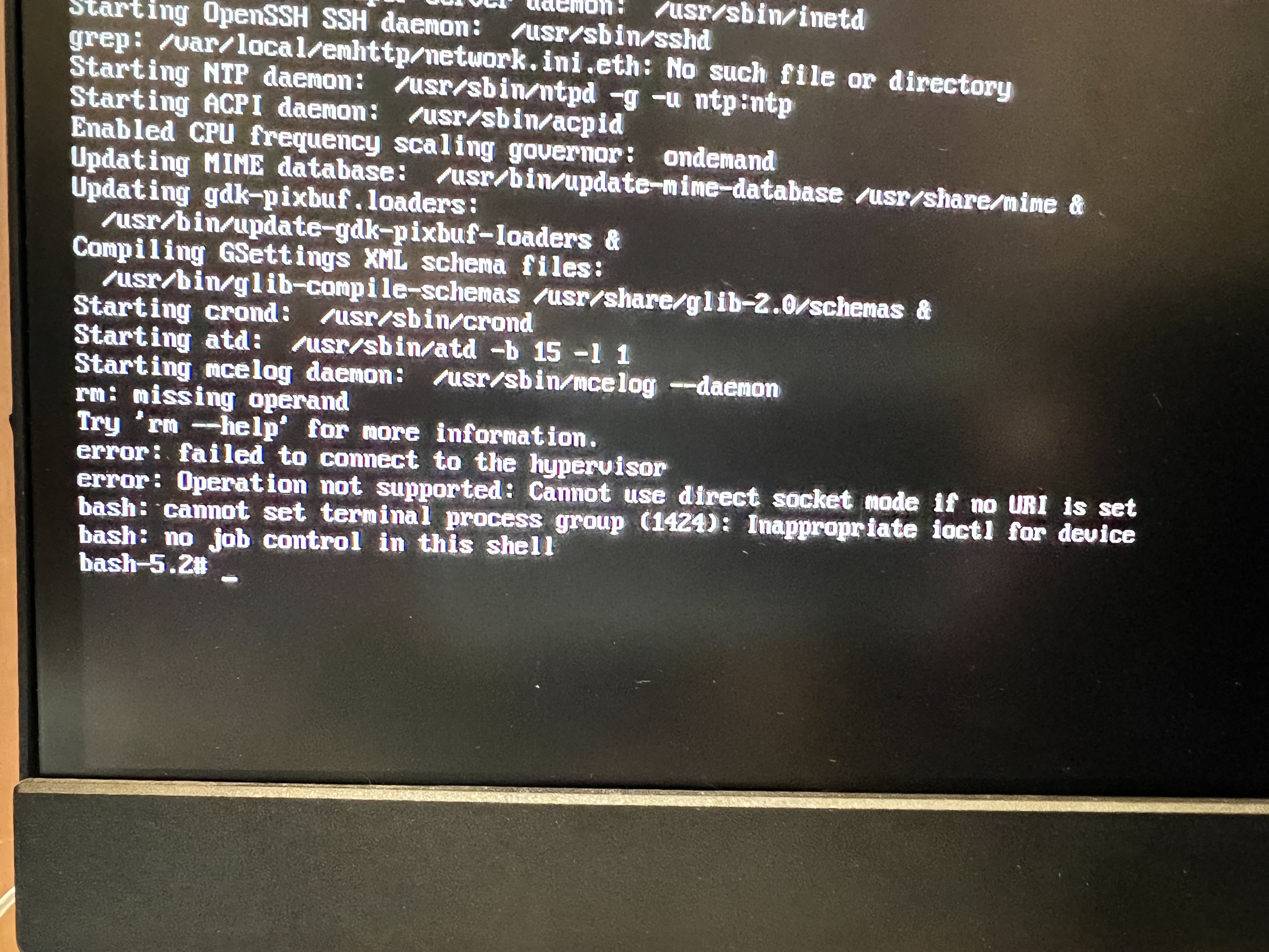

  6. 找不到eth0的设备了,但是lspci中能看到网卡,flash备份到是可以解决,就是u盘在机器内,很麻烦。
  7. I can't access this file now. The array is not started, so I can't enter the folder where the file is stored. BTW I cannot find the file "network-rules.cfg" under the "/boot/config" folder, but there is a file named "network.cfg". When I try to search for the "eth0" device, it shows that the device does not exist. However, I can see my network card in the "lspci" command.
  8. I have installed this plugin, but now the network configuration is lost and I cannot access the server. In the local terminal, I can see the previously set static address for the server, and it seems that there is also a network card in the PCI device. However, I don't know how to restore the network connection. Can anyone help me?

  11. 重新从备份中恢复U盘后,设备启动了,数据保住了,估计U盘出了点什么问题。
