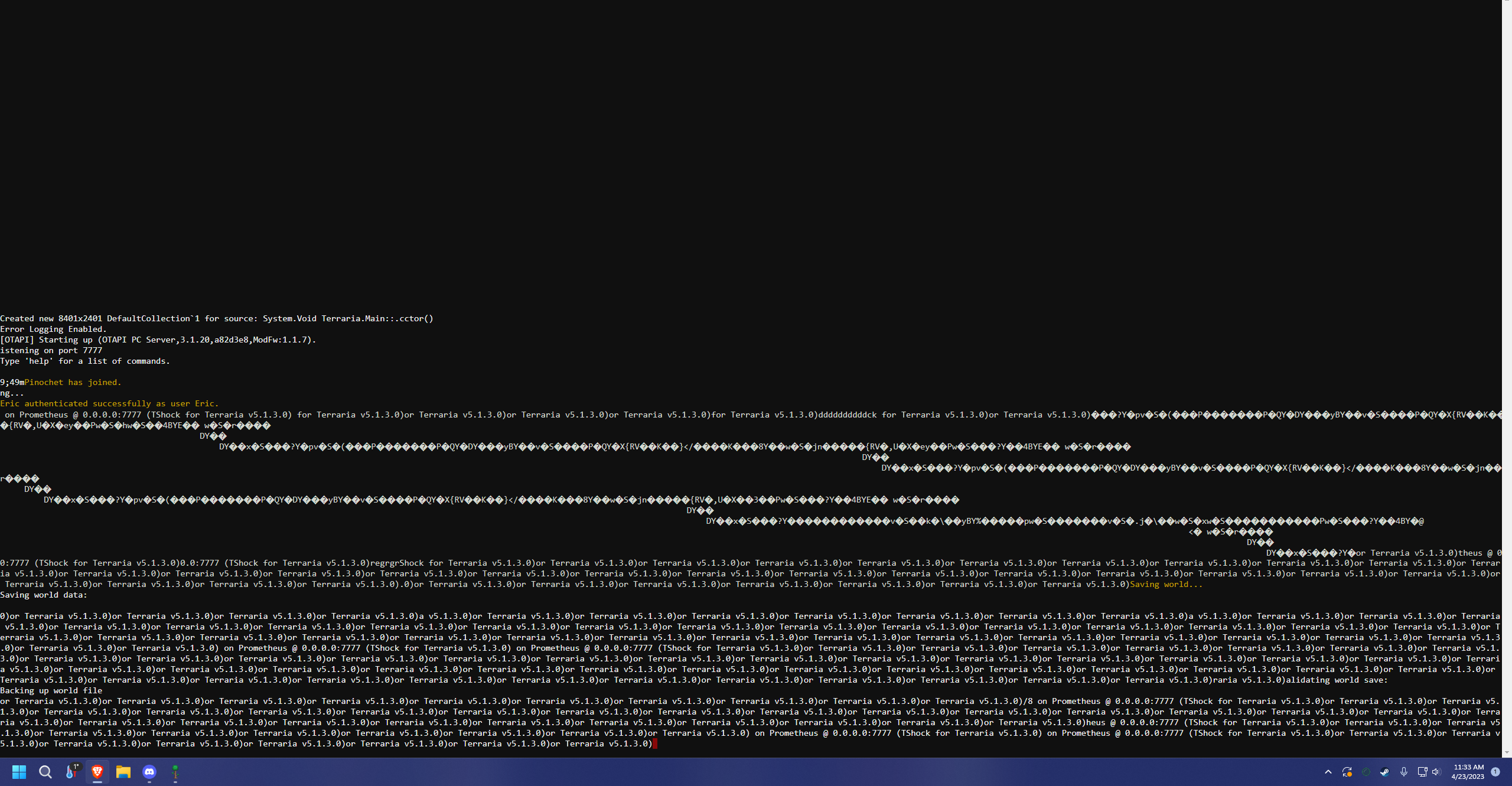

  13. I cannot for the life of my get amp to work. It runs, i set up the instance, update it and start it. Shows its running, but I can't connect to it by either the local ip, or public ip. Game is just never found. I have no idea where i am going wrong. Forwarded the port i chose for the game below and i am using the unraids ip to connect locally. Tried using a vpn and my public ip, still nothing. Just times out, some games say not found. Is this even alive? I see a lot of people asking for help and 0 responses.
  14. No mods installed, im just using tshock to force serverside characters which is built in.
  15. Full screen or not doesnt matter same outcome, using docker exec -u terraria -ti [Name of your Container] screen -xS Terraria Shows the same as webui and i cant type anything there either. or Terraria v5.1.3.0)or Terraria v5.1.3.0)or just keeps repeating every few seconds endlessly I do see stuff we type in game appear in the ui, but that just keeps posting
  16. So weird, mine is all garbled and i cant type. Have tried multiple browsers too.
