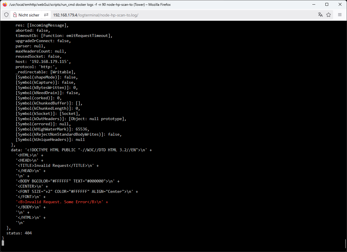

jetzt hab ich alles nochmal so gemacht wie du... mit - jetzt geht nix mehr hab ich gemeint, dass er die Protokolle nicht mehr angezeigt hat 😞 Ziel von dem Docker soll irgendwann sein, dass ich direkt in den Docker paperless scannen kann - der Laserdrucker kann nicht auf smb scannen...

Hallo zusammen, danke das ihr mir helfen wollt. Ich glaube nur, ich habs verbockt... Jetzt kommt gar nix mehr...

und das ist mein Containerprotokoll s6-rc: info: service s6rc-oneshot-runner: starting s6-rc: info: service s6rc-oneshot-runner successfully started s6-rc: info: service fix-attrs: starting s6-rc: info: service fix-attrs successfully started s6-rc: info: service legacy-cont-init: starting cont-init: info: running /etc/cont-init.d/10-adduser cont-init: info: /etc/cont-init.d/10-adduser exited 0 s6-rc: info: service legacy-cont-init successfully started s6-rc: info: service legacy-services: starting s6-rc: info: service legacy-services successfully started /run/s6/basedir/scripts/rc.init: line 76: manuc66/node-hp-scan-to: not found s6-rc: info: service legacy-services: stopping s6-rc: info: service legacy-services successfully stopped s6-rc: info: service legacy-cont-init: stopping s6-rc: info: service legacy-cont-init successfully stopped s6-rc: info: service fix-attrs: stopping s6-rc: info: service fix-attrs successfully stopped s6-rc: info: service s6rc-oneshot-runner: stopping s6-rc: info: service s6rc-oneshot-runner successfully stopped s6-rc: info: service s6rc-oneshot-runner: starting s6-rc: info: service s6rc-oneshot-runner successfully started s6-rc: info: service fix-attrs: starting s6-rc: info: service fix-attrs successfully started s6-rc: info: service legacy-cont-init: starting cont-init: info: running /etc/cont-init.d/10-adduser cont-init: info: /etc/cont-init.d/10-adduser exited 0 s6-rc: info: service legacy-cont-init successfully started s6-rc: info: service legacy-services: starting s6-rc: info: service legacy-services successfully started /run/s6/basedir/scripts/rc.init: line 76: manuc66/node-hp-scan-to: not found s6-rc: info: service legacy-services: stopping s6-rc: info: service legacy-services successfully stopped s6-rc: info: service legacy-cont-init: stopping s6-rc: info: service legacy-cont-init successfully stopped s6-rc: info: service fix-attrs: stopping s6-rc: info: service fix-attrs successfully stopped s6-rc: info: service s6rc-oneshot-runner: stopping s6-rc: info: service s6rc-oneshot-runner successfully stopped usermod: no changes User uid: 1000 User gid: 1000 ------------------------------------- usermod: no changes User uid: 1000 User gid: 1000 -------------------------------------

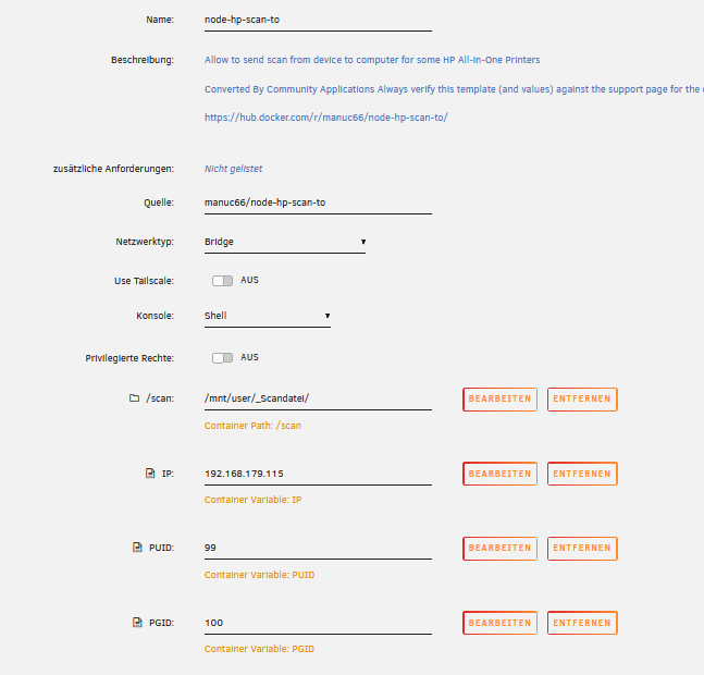

also das ist meine Docker run: docker run -d --name='node-hp-scan-to-1' --net='bridge' --pids-limit 2048 --privileged=true -e TZ="Europe/Berlin" -e HOST_OS="Unraid" -e HOST_HOSTNAME="Tower" -e HOST_CONTAINERNAME="node-hp-scan-to-1" -e 'NODE_VERSION'='18.20.7' -e 'YARN_VERSION'='1.22.22' -e 'NODE_ENV'='production' -e 'Community_Applications_Conversion'='true' -l net.unraid.docker.managed=dockerman -v '/mnt/user/_Scandatei/':'/scan':'rw' -d -e IP="192.168.179.115" -e PGID=1000 -e PUID=1000 docker.io/manuc66/node-hp-scan-to 'manuc66/node-hp-scan-to' cde1aa746860767abfea6ae3cdedf5bb382b5cfbf6490f6520647b9b2fbf14a9 Der Befehl wurde erfolgreich ausgeführt!

Hallo zusammen, Ich würde gern folgenden Docker https://manuc66.github.io/node-hp-scan-to/ zum laufen bringen. Installieren und starten ist nicht so schwer. Das hab ich geschafft. Aber er meckert das die config Datei nicht erstellt wurde und ich kann die Befehle/ Argumente die nach docker run kommen nicht richtig eingeben. in dem Ordner in dem die normalen Apps sind ist kein Ordner der node-hp-Scan-to heißt. Ich würde Ungern Portainer installieren wegen dem einen Container. Kann wer helfen?

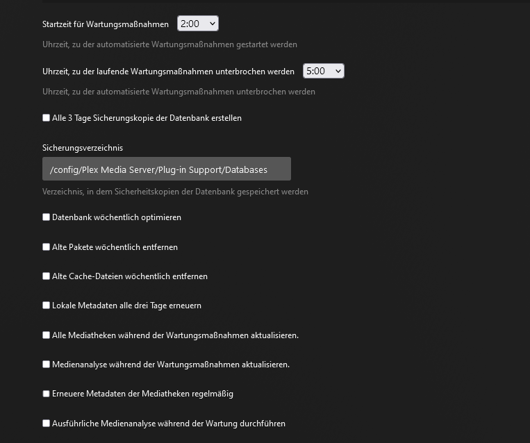

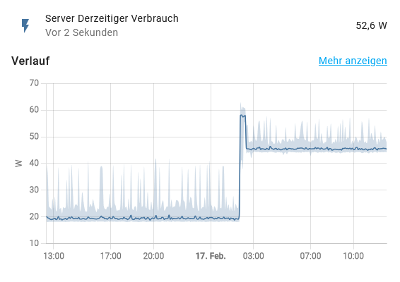

vielen Dank für die zahlreichen Ratschläge. @alturismo Es ist wahrscheinlich plex. Ich hab den Container am laufen. Ich habe mal einen screenshot von Plex angefügt. Hab aber auch schon probiert, alle geplanten Tasks abzuschalten. Und den Stromverbrauch... Ich habe ja kein Problem mit dem um zwei uhr starten aber er geht ja nicht wieder zurück... @ich777 hab auch noch die diagnose zip angefügt. Wenn jemand noch eine Idee hat wäre ich dankbar. datengrab-diagnostics-20240217-1230.zip

hallo zusammen, ja plex habe ich installiert und habe ich auch in Verdacht gehabt. Aber die Wartungsmaßnahmen kann doch nicht länger als 24 h dauern? Der Stromverbrauch geht nämlich nicht mehr zurück... @saber1 soll ich die ganze zip-datei posten?

Hallo Community, ich hoffe, ihr könnt mir bei einem ungewöhnlichen Problem mit meinem Unraid-System helfen. Ich nutze Unraid 6.12.6, das am 01. Dezember 2023 aktualisiert wurde. Mein Ziel ist es, das System so stromsparend wie möglich zu betreiben, aber dabei auf gebrauchte Hardware zu setzen. Meine Konfiguration umfasst 4 x 3,5-Zoll-Festplatten ohne Array sowie 2 SSDs, auf denen Docker und VM laufen. Normalerweise beträgt der Stromverbrauch etwa 18 Watt, was meinen Erwartungen entspricht. Allerdings habe ich festgestellt, dass um 2 Uhr nachts der Stromverbrauch auf 40 Watt ansteigt, und eine der Festplatten beginnt zu laufen. Diese bleibt dann auch aktiv. Ich bin ratlos, welcher Prozess oder welche Anwendung diesen plötzlichen Anstieg verursacht. Gibt es eine Möglichkeit, dies herauszufinden? Ich habe bereits versucht, die Systemprotokolle zu überprüfen, konnte jedoch keine spezifischen Informationen dazu finden. Habt ihr Ideen oder Vorschläge, wie ich den Verursacher dieses plötzlichen Anstiegs des Stromverbrauchs identifizieren kann? Vielleicht gibt es spezifische Tools oder Protokolle, die ich übersehen habe? Vielen Dank im Voraus für eure Unterstützung! Viele Grüße,

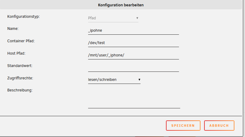

Hallo, hier der Screen. Wie gesagt, ich glaube ich krieg das schon hin, dass ich ihn an den Docker weitergebe. Ich kann ihn da aber nicht mounten - so das ihn dsm sieht. Ich hab es jetzt mal über remote folder gelöst. Denke aber das ist langsamer... So wie ich die Hilfe (https://github.com/vdsm/virtual-dsm) lese, kann man keine Ordner einfach so einhängen. Da muss man immer diese Laufwerke generieren...
