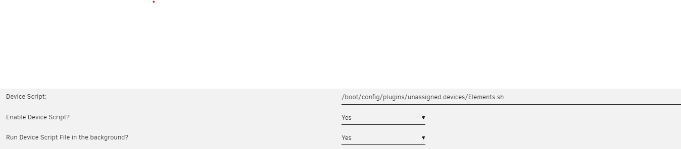

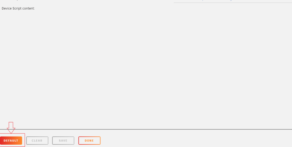

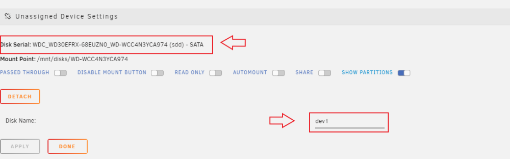

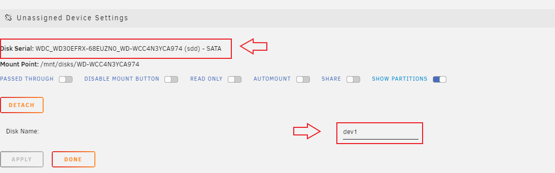

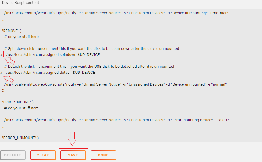

  8. Hey, Thank you for the wonderful script! Saved me a lot of time. I tried to figure out how I can ensure that the backed up data is not acessible anymore once the backup is done. My understanding is that spinning it down and detaching it will do the trick. This can be achieved by using the unassigned device plugin as mentioned by OP. Here is a short manual which works for me. Any feedback is appreciated. Updating Unassigned Devices Default Script 1. First, you want to adapt the unassigned devices script by uncommenting the sections of the default script. Click on the settings button in the unassigned devices section (Main tab). 2. Copy Disk Serial and Disk Name to a notepad. You will need them later. My Disk Serial in this example ends at "74". Do not copy blank space or the brackets. Note: @dlandon pointed out: Do not use "devX" device names. Assign a unique name to the 'Disk Name' field as an alias and use that in your script. Take the time to update it here and save the change before proceeding to the next steps. 3. Scroll down to find the script section. Click on "Default". It will load the default script to the Device Script content. At this stage, the script does nothing. 4. Uncomment the "remove" section activities by removing the hashtag. Effect: Once unmounted, the disk spins down and deattaches. Click on Save. 5. Scroll up and select the device script. Yours will have a different name, but there is probably only one to select. -------------------------------------------------- Switch to the User Scripts: 6. Open the script which you created for the backup based on OPs script. 7. Add lines at the beginning and the end of the script to attach, mount and unmount the usb device. You will need the saved information from the first step: Disk Serial and Device Name. Note: I am using different devices than at the beginning here, do not let this confuse you. Just copy & paste the information you saved before. ### mount external USB drive /usr/local/sbin/rc.unassigned attach 'device serial number' /usr/local/sbin/rc.unassigned mount name='device name' # unmount the usb device /usr/local/sbin/rc.unassigned umount name='device name' You can test the command without processing the full script by copy and pasting them in the command line of your unraid system. Note that attaching and mounting will take some time (~10 seconds for me). Just wait and see if it pops an error or hopefully just works. Source:
