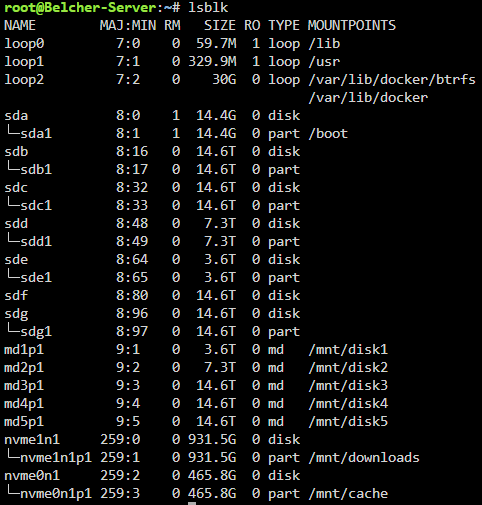

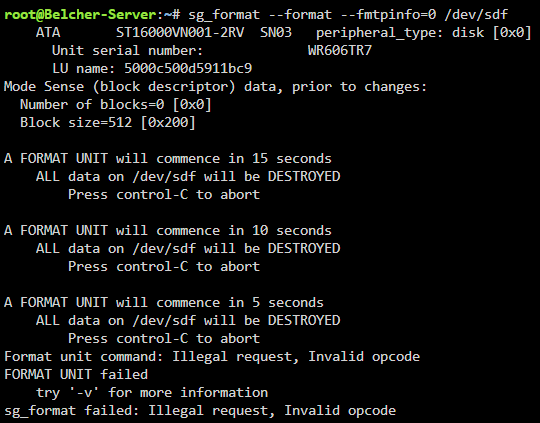

  11. Tried 4 other cables, all brand new, nothing. Took it out and connected it to my external enclosure and plugged it into my Win11 machine, as soon as it spins up, the head clicks every second forever and never shows up in the file system. Hit the nail right on the head; Thanks so much!
