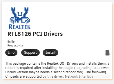

you may need a reltek plugin install. or user scirpt to update teh ethtool for 2.5 connecitons as noted here:
https://forums.unraid.net/topic/141349-plugin-realtek-r8125-r8126-r8168-and-r815267-drivers/#findComment-1279775

depends onthe card but yes if its a realktek card you install the unraid plugin. and what lspci -v
or diag file says the drive is using and teh speeds being told to unraid.
data can be found here with a diag file.
per
you would need to run a user sciurpt plugin to add the other speed to the interface via the ethtool commands

realy depends on what lspci - says teh kerneal driver in use is. aloth of manfacutres use realtek chips ... I think the realktek plugin is what you need.
otherwise the support form on that pulgin may be of futer assistnace.
