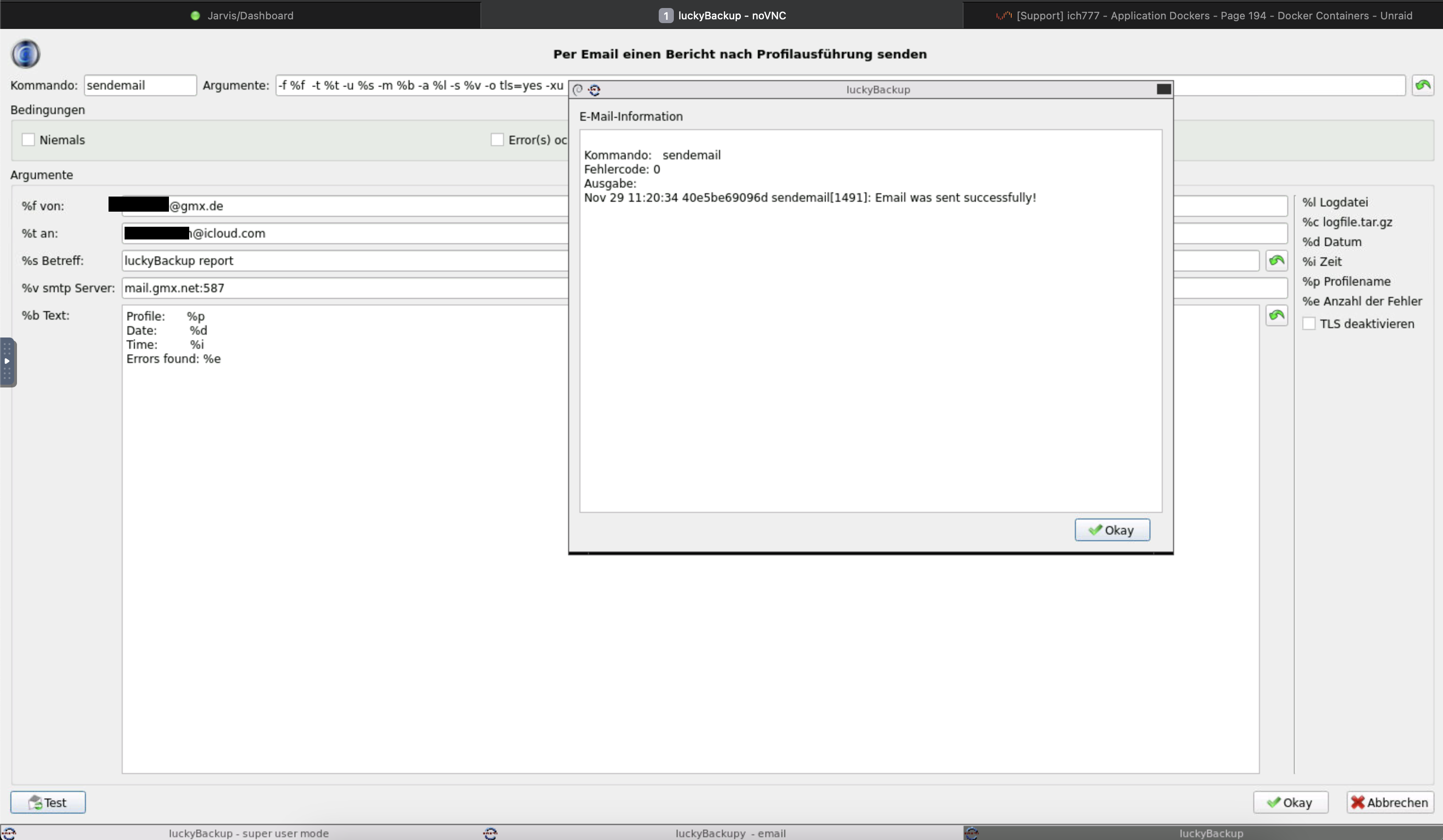

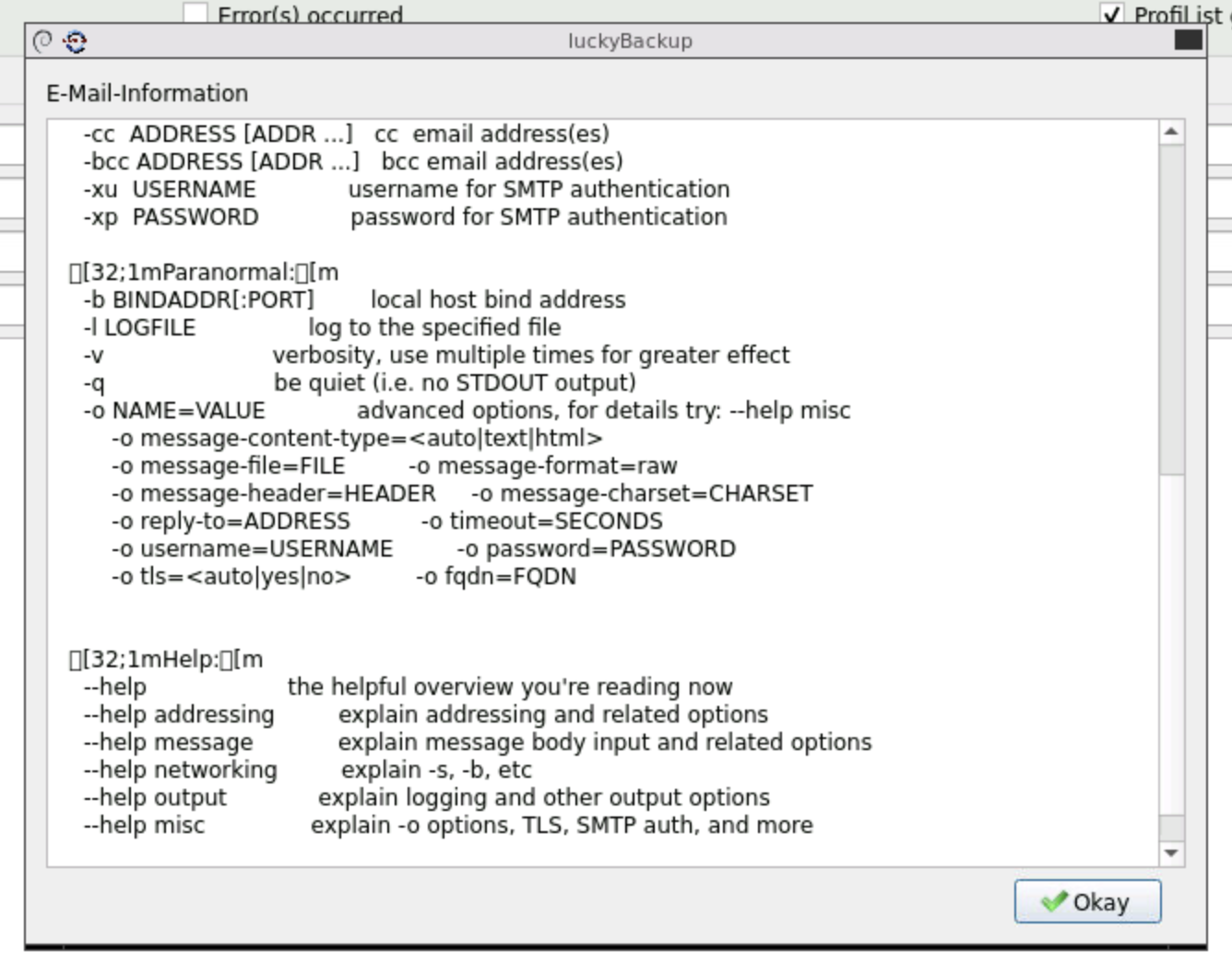

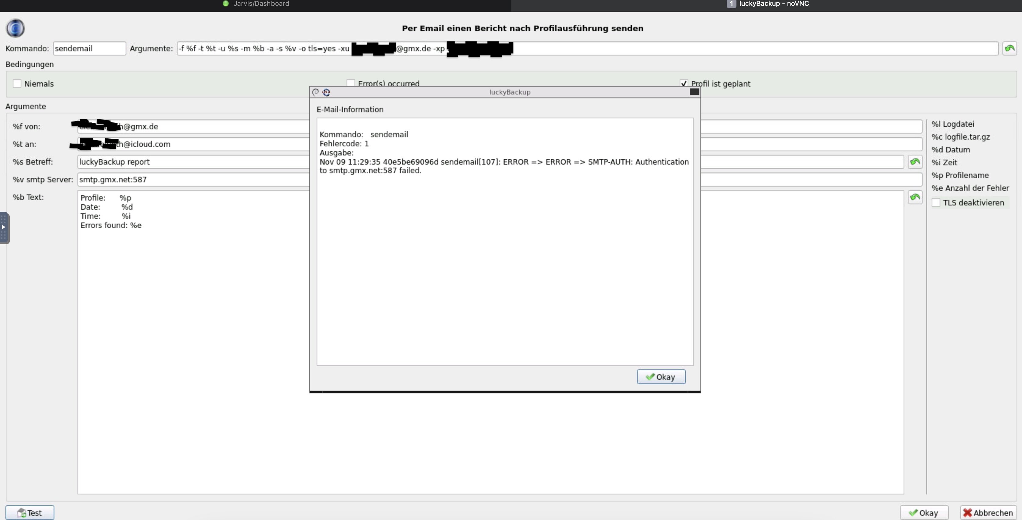

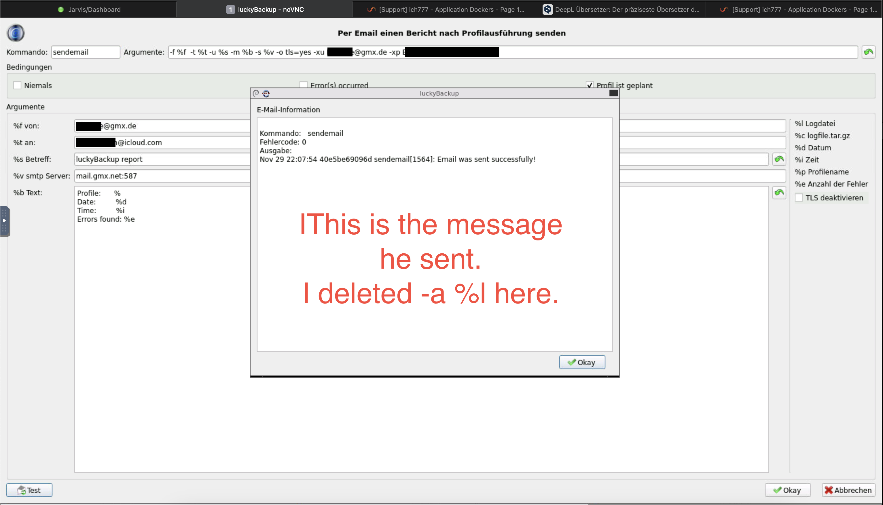

  3. I did that via the LuckyBackup console as you described. So, Unraid GUI, then right-click on the LuckyBackup icon, then on Terminal. An error message appears here. But not on the next screen? Why is that? ***removed*** This was sent by. I have -a %l deledet. And in the GUI of LUCKYBACKUP Here, I deleted the -o command. That's when this error message appeared. The two images that follow belong together. ***removed*** This is the same Window in the middle when I scroll down I don't understand. It started when he stopped using the password. Apparently, this can be done via the LuckyBackup GUI itself. The command in the LuckyBackup terminal does not work. I don't understand that. But I'm no expert. Please help me.

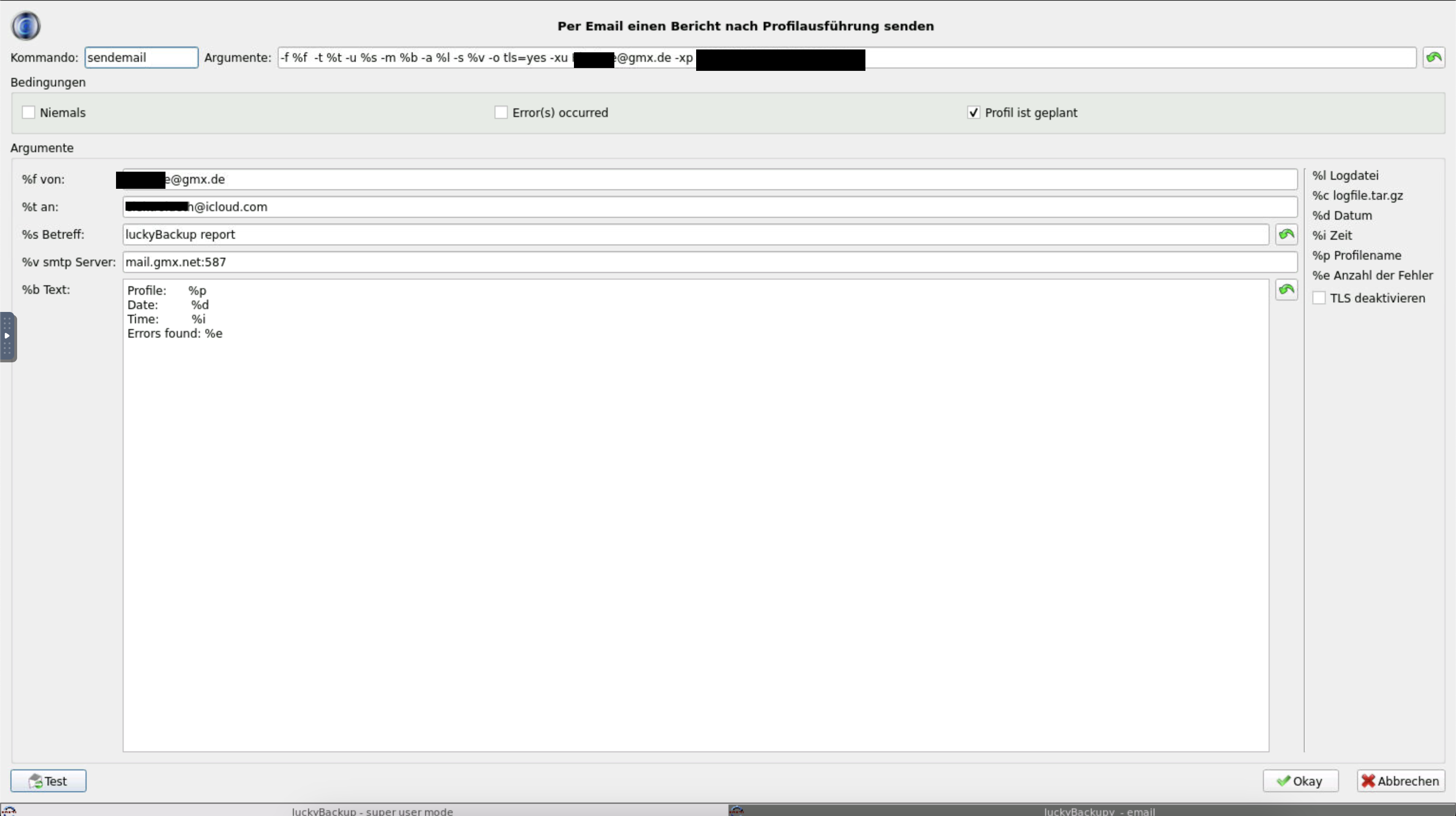

  4. This is my setting for sending emails after a backup job. But as I already wrote, it doesn't work. I would be very grateful for any helpful answers. Best regards This is the message that appears after the automatic backup has been completed. I clicked the test button for this.
  5. Hello, I have now managed to get the email to send and have entered everything according to the instructions in Arguments. Now, when I click on Test, it sends the email. That's great. I then ran a backup and was very proud that it worked with the email. Unfortunately, it doesn't send it automatically when the backup is finished. What else have I done wrong? I'm slowly losing heart.

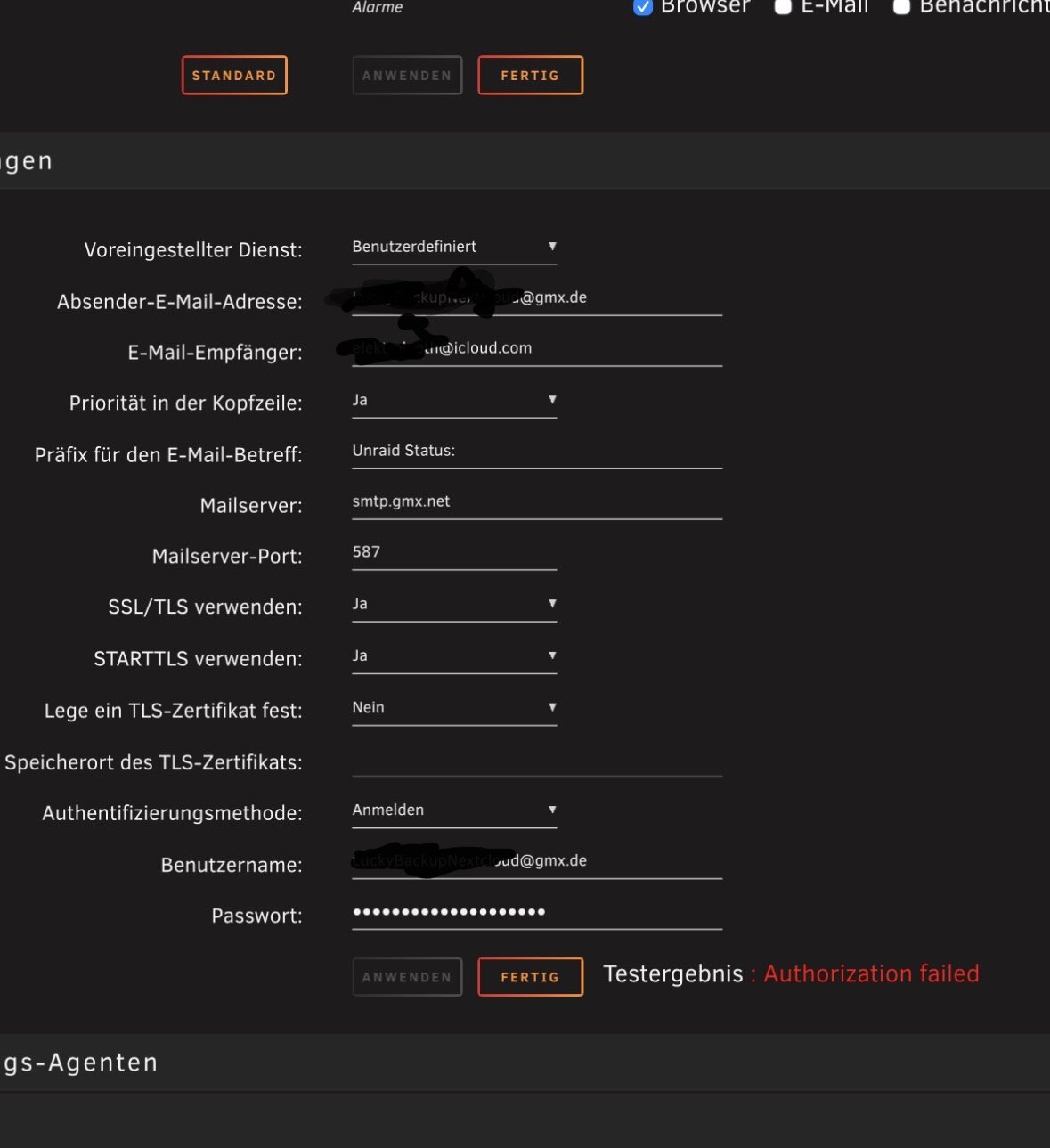

  13. Guten Morgen , Ich habe es in Unraid getestet siehe Foto. Habe mir auch ein App Passwort eingerichtet. Ich verstehe es nicht was machen ich falsch?
