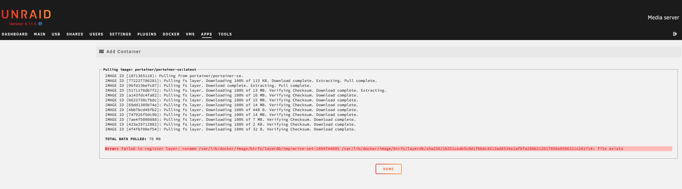

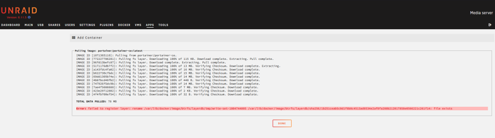

  10. Hello, maybe somone can help me. I am trying to reinstall portainer due to permission issues, but it fails with Error: failed to register layer: rename /var/lib/docker/image/btrfs/layerdb/tmp/write-set-1804744805 /var/lib/docker/image/btrfs/layerdb/sha256/1b251ceab5c0d1f6b8c4513ad8534e2af0fa288b212017858e0566221c261f14: file exists the other containers like adguard and frigate are installed without any problem. Thank you
