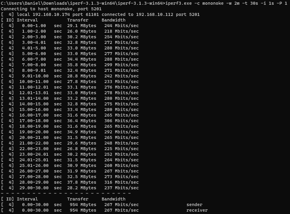

  6. I appreciate the response! The 5GHz channel was initially at 80Mhz, no change in speed when switching to 160Mhz. What's bothering me is using speedtest.net, I can get a download speed of 510Mbps, yet the data transfer from desktop to NAS is almost half of that.
  7. I've been searching and reading posts all day and I can't find anything that would fix this speed issue, does anybody have any input? I've disabled as many services/processes as possible including AV/etc, updated my adapters driver, uninstalled and reinstalled the adapter driver, all with no change.

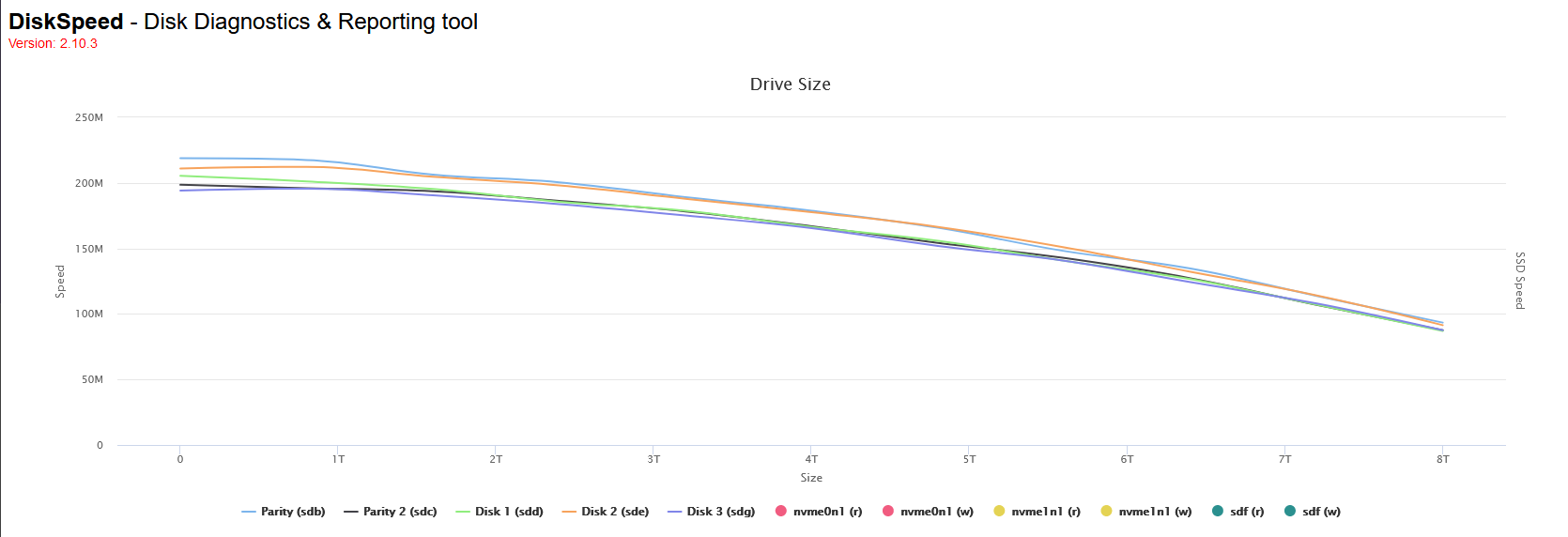

  8. Alright, I feel a bit dumb but I tested on one of my laptops which has the same link speed (866/866) and am getting an average of 542Mbits/sec. I'll see what I can find, but what would typically be the reason for this? How can I maximize the speed on both my laptop and desktop?
