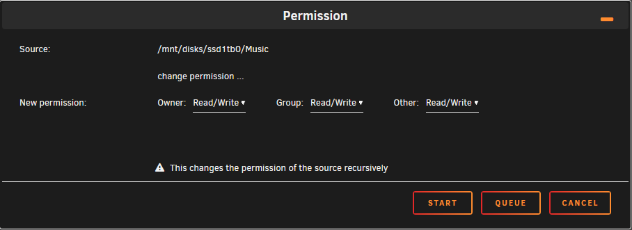

  5. I installed the Dynamix File Manager and set the permissions for group and other to read/write, this appears to be how the other UD folders are cofigured - it's weird that UD did not use the same permissions it had configured on the other drives, the issue is now resolved.
  6. I've changed the UD SMB setting but how would I reset the permission on the drive? Thank you.

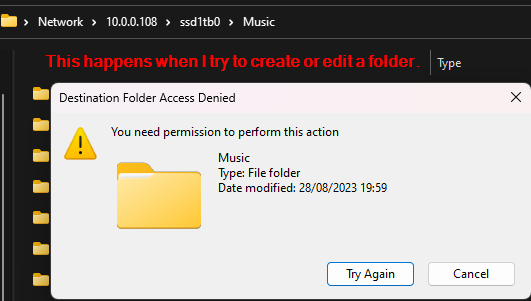

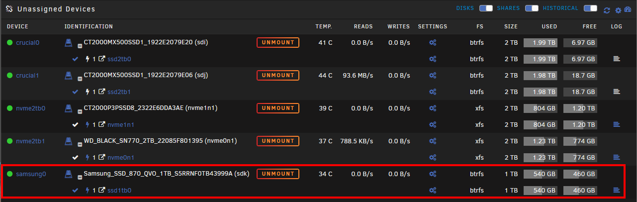

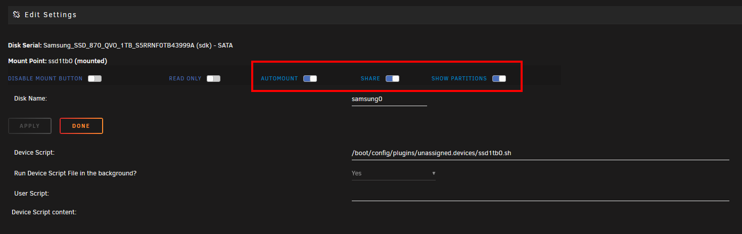

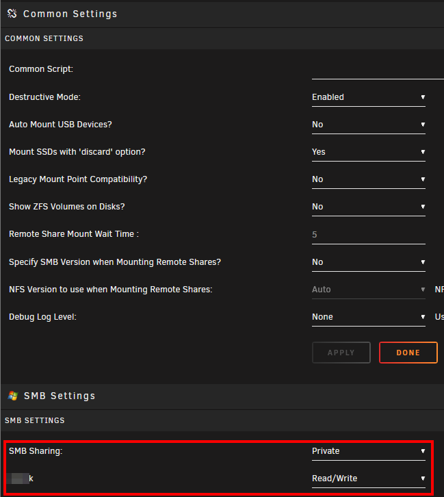

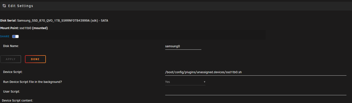

  7. Hey, many thanks for the help, the read only switch is not set. Diagnostics attached. dansunraidnas-diagnostics-20230903-1602.zip
  8. Hey, I just added a new SSD to unassigned devices. I formatted it btrfs and mounted and shared it without issues. I have set up unassigned devices to share via SMB with read/write permissions for specific users. I have 4 SSDs that I access via SMB (shared by UA) with the configured permissions without any issues. For some reason on this new SSD, my user doesn't have write permissions despite it being configured in the UA SMB settings. It's working fine on all my other drives. Any idea why UA hasn't applied the correct permissions to this new device? I moved files to the mounted drive via the terminal without issues, I just can't add files via SMB as apparently I don't have permission. I can read without issues. I've tried to remove and reapply the SMB permissions, and unmount / mount the drive. Not sure how to fix this, any advice would be appreciated.
