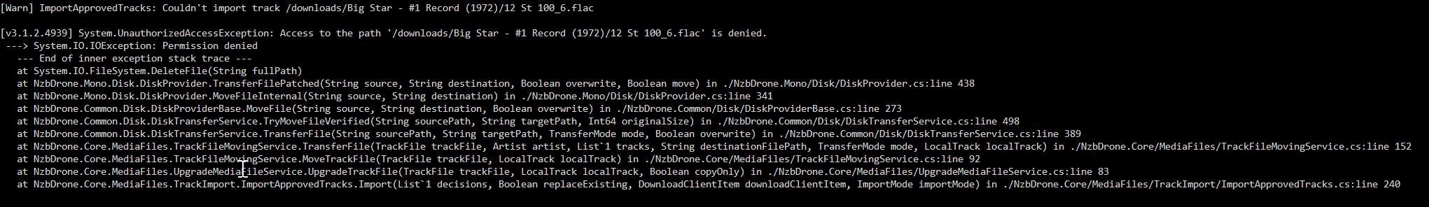

  1. I tried the suggested fix (add "--user 99:100" without the quotes into the "Extra Parameters" field) and I think it fixed it, imported a couple albums now successfully. Thank you! I was really thinking this was a lidarr issue since it didn't happen until lidarr tried to import.

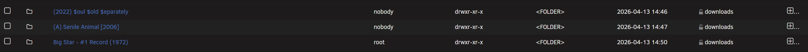

  2. I'm trying to get Soularr working and I have Lidarr, and slsk working and soularr is downloading music but when Lidarr tries to import it I keep getting Permission denied error The weird thing is that when slskd downloads them it saves them with permissions for "nobody" then when Lidarr tries to import it somehow the permissions change to "root" While downloading and until Lidarr tries to import the owner is "nobody" then as soon as Lidarr tries to import it switches the owner to "root" and I get the error above any idea what would cause this? my Lidarr container has PUID=99, PGID=100, and UMASK=000 (also tried umask=022)
