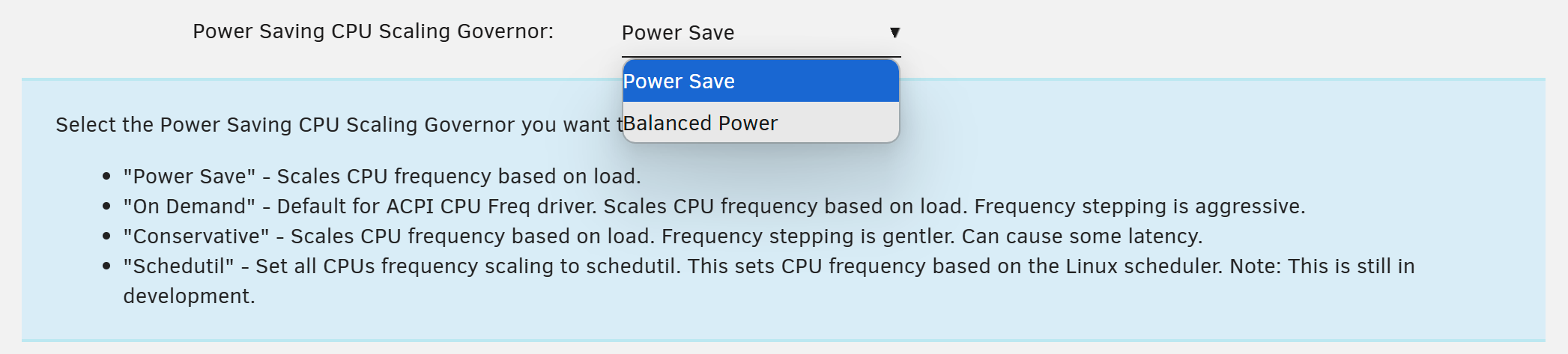

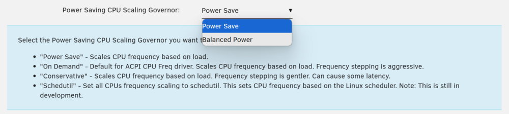

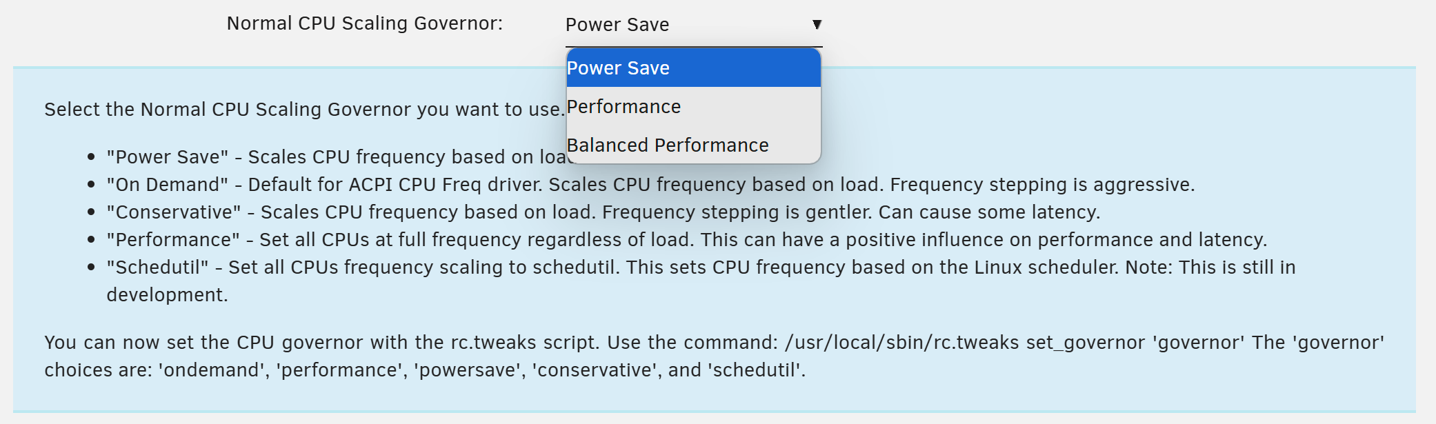

@dlandon Thank you for the new version of this plugin. But some settings are missing. At "Normal CPU Scaling Governor" there is missing "Balanced Power". At "Power Saving CPU Scaling Governor" there is missing "Balanced Performance". And the descriptions maybe need to be updated. My CPU does only support "performance" and "power save" :((

With the driver "AMD Pstate" you can only set the Governor to "Power Save" and "Performance". "On demand" and "conservative" does not work.

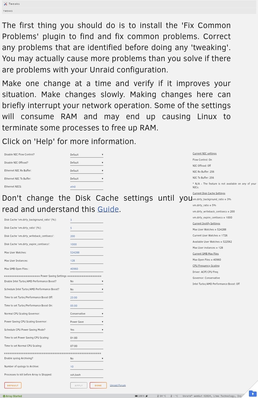

@dlandon What information is missing? I think everything is displayed on my screenshots. Where can I find the missing information? Thats the complete area at the settings with Unraid 6:
