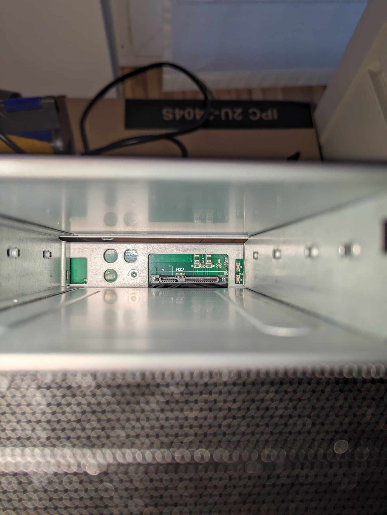

  14. I'm affraid that there is no information about power in pi3. Ports looks like in attachment. I think will try hack with cover pi 3 on hdd, becouse its my last idea.
  15. This case: https://www.inter-tech.de/productdetails-144/2U-2404S_EN.html And drives are Toshiba N300.
