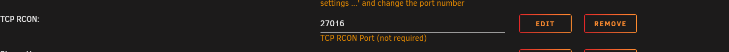

  15. Yes, Port Set below, I will remove it from the GAME_PARAMS section, reboot and see if it works. there was no server.cfg generated by the server when I installed it, so i created my own....it only has rcon_password my_server_rcon_password in it
  16. Trying to get rcon working in CSGO, I've tried a few differnet additions to the game parms +rconpw PASSWORD and +rcon_password PASSWORD but i cant seem to access it when playing, not sure if i'm doing this correct. I also tried adding a server.cfg file to /appdata/csgo/cfg folder, but didnt seem to make a difference....any advice?
