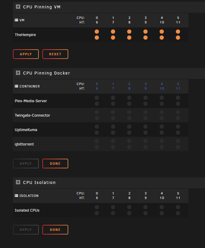

  2. Hi Everyone! I have a Ubuntu VM hosting two Rust game servers: one 4.5k vanilla server and a smaller 2k build server for friends and loyal players. Additionally, I run Docker with a Plex media server (with iGPU passthrough), a torrent server (mostly off), and a Twingate connector for remote access. I also use the Server to back up my home PCs. Despite several optimizations, I'm still experiencing stuttering on my Rust servers. Here's what I've tried so far: Isolated the VM's cores, utilizing 4 isolated CPU cores. The remaining 2 CPU cores are pinned for Docker. Set an emulator pin to a different core. Disabled cache. Tried disabling hyperthreads on the VM's cores but I see no change. I've also made changes to the Rust server configuration file to improve performance, such as adjusting population settings and server tick rates. While monitoring resource usage, I've observed memory usage at 24-15% and CPU usage at 37-10% for the two Rust servers running on the VM. The VM is hosted on an Intel 11600k CPU, and the NVMe SSD, where the VM resides, is directly connected to the CPU. And I have fiber internet. Considering my setup, could anyone provide insights or suggestions for further optimizing my server to resolve the stuttering issue? Any help would be much appreciated!
  3. Hi Everyone! I was wondering whats best practice in my case? I have a Ubuntu VM with 2 Rust game server (one big vanilla, no decay and a small build server for friends and loyal players) On docker i run a plex media server for a few friends and familly, a torrent server thats mostely off and a twingate connector for remote acces. For the rest i just use it to back up my home pc's i noticed after making some tweek i still have a little stutter on my Rust servers thats wy im trying to optimize the server to its max potential but sadly my technical know how only goes so far. and CPU pinning is that one bridge to far So i wonder how i can best set them up? Also how do i find out what are Cores/Threads and whats the difference? I added the a example from my current cpu but i have a 11600k on the way so i can use the igpu for plex
