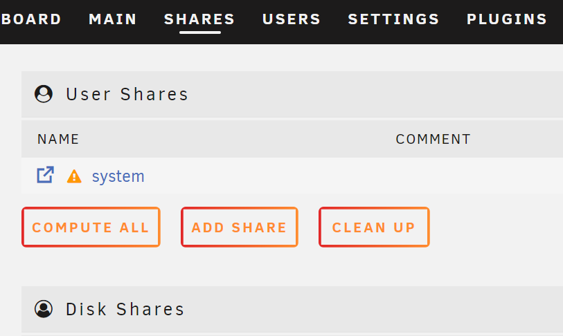

  2. Hello all, I did a fresh, new install on a new Unraid server with blank disks. I did this becuase I had done a lot of fumbbling around to get things the way I wanted, and I wanted to "start over". Doing this seemed to work fine, but I only have one user share: "system". I don't have an "appdata" or anything else. Shouldn't I have 4 shares starting out? (I did the refresh by going onto my flash drive, removing all of the /config folder (except for go and Trial.key) and rebooting off of it. Apparently I screwed something up. I'd be most grateful if someone showed me the error of my ways... Thanks very much Brent Diagnostics attached. gretzky-diagnostics-20231114-1508.zip

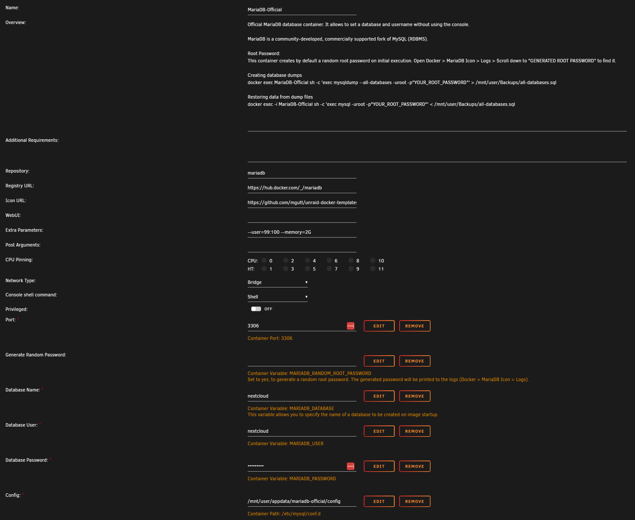

  5. These are the settings I used to create the MariaDB container:
  6. Bah, I just noticed the advanced settings switch, and sure enough, there was mysqld_safe --skip-grant-tables in the Post arguments. I'm sorry. Edited the container, still failed, here is the log: 2023-11-06 2:35:47 0 [Warning] Can't create test file /var/lib/mysql/599ca10ebea3.lower-test 2023-11-06 2:35:47 0 [ERROR] mariadbd: Can't create/write to file './ddl_recovery.log' (Errcode: 13 "Permission denied") 2023-11-06 2:35:47 0 [ERROR] DDL_LOG: Failed to create ddl log file: ./ddl_recovery.log 2023-11-06 2:35:47 0 [ERROR] Aborting 2023-11-06 02:35:47-06:00 [Note] [Entrypoint]: Entrypoint script for MariaDB Server 1:11.1.2+maria~ubu2204 started. 2023-11-06 02:35:47-06:00 [Note] [Entrypoint]: Initializing database files Installation of system tables failed! Examine the logs in /var/lib/mysql/ for more information. The problem could be conflicting information in an external my.cnf files. You can ignore these by doing: shell> /usr/bin/mariadb-install-db --defaults-file=~/.my.cnf You can also try to start the mariadbd daemon with: shell> /usr/sbin/mariadbd --skip-grant-tables --general-log & and use the command line tool /usr/bin/mariadb to connect to the mysql database and look at the grant tables: shell> /usr/bin/mariadb -u root mysql MariaDB> show tables; Try '/usr/sbin/mariadbd --help' if you have problems with paths. Using --general-log gives you a log in /var/lib/mysql/ that may be helpful. The latest information about mariadb-install-db is available at https://mariadb.com/kb/en/installing-system-tables-mysql_install_db You can find the latest source at https://downloads.mariadb.org and the maria-discuss email list at https://launchpad.net/~maria-discuss Please check all of the above before submitting a bug report at https://mariadb.org/jira ** Press ANY KEY to close this window **
  7. No. I wouldn' tknow where to add it.
  8. No, the container name is MariaDB-Official, the db name is nextcloud. (That's the command specified in the first post of the thread, with mariadb substituted with nextcloud.) Yes, It's not running. Trying to figure out why. Here is what I have for the log file: /usr/local/bin/docker-entrypoint.sh: line 617: exec: mysqld_safe: not found /usr/local/bin/docker-entrypoint.sh: line 617: exec: mysqld_safe: not found ** Press ANY KEY to close this window ** I've deleted the container and restarted a few times with the same result each time.
