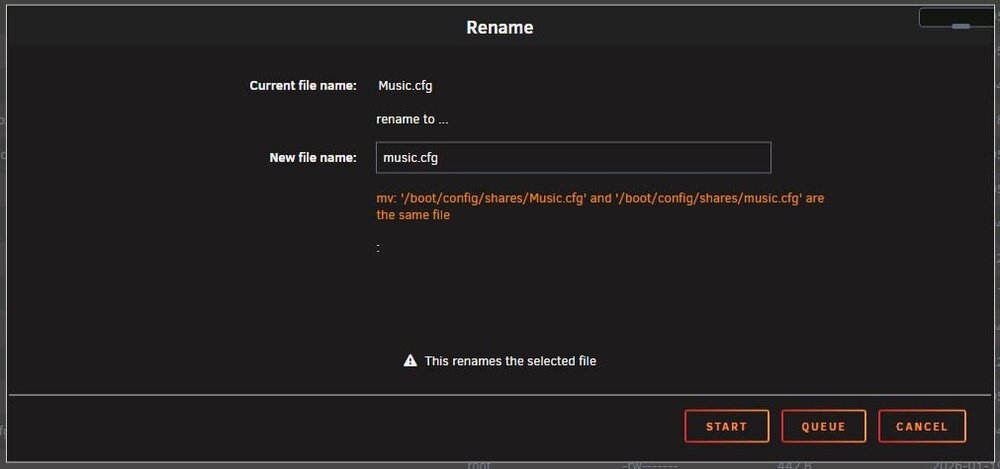

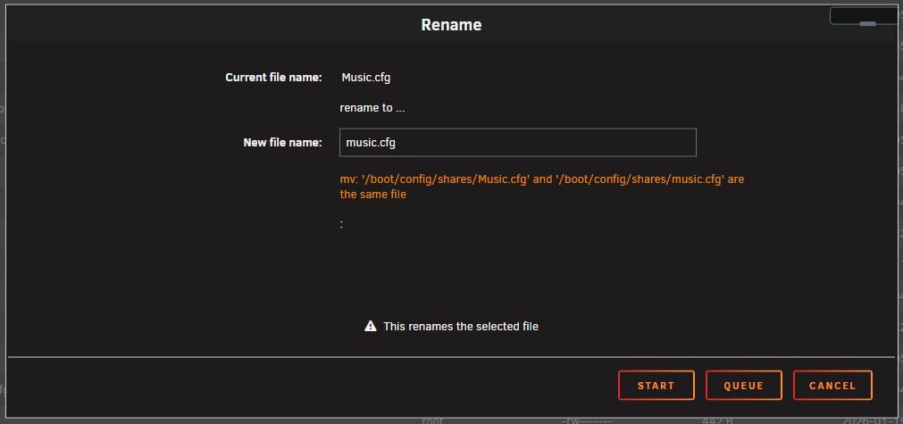

  2. I guess I cannot do this through the unraid gui - I get the error - mv: '/boot/config/shares/Music.cfg' and '/boot/config/shares/music.cfg' are the same file. I will try tonight when I am not remote and post back here.
  3. I would love a bit of help/reassurance - I lost my cache ssd drive on my main array. I had a previously installed nvme drive that I had moved my appdata over onto, so I decided to not replace the cache drive at this time. I just noticed that some of my shares are now unavailable and in the shares detail it has moved storage onto the nvme drive and I cannot edit any of the properties. I also have a case-insensitive share name non unique error on the share. In my flash/config/share directory, the share is listed as Music.cfg but in the unraid share it is listed as lowercase music. Is the fix to change the case on either the .cfg file or the unraid share detail, or something else? If I click through the share my data is still present. I did check, and I only have 1 .cfg file for the share. tower-diagnostics-20260315-1031.zip

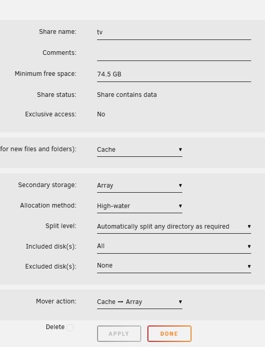

  5. I have a mover problem. I am sure it is something silly, but I cannot find it! I have a share (tv) that is set to move from cache to array every night, there is room on the array and I do not have mover tuning plugin installed, I have disabled docker and triggered the the mover command through the mover settings tab with mover logging enabled, I see the mover starting in the syslog, and then the mover completion 1 second later without any movement of the files in the share (also no error). I have run check common problems. Any other places to look for problems? I am on 7.1.4 tower-diagnostics-20250726-1013.zip
