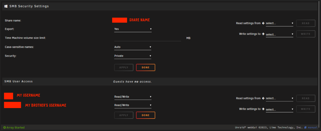

  6. Thanks for responding, this is the screenshot, also with the sensitive data blocked in red (with red text to indicate what used to be there) The thing is though; I can access the share and I have access to one of the four folders in the share, so as far as I understand it, it cannot be my credentials or the Read/Write setting here.
  7. I am fairly new to configuring my own server. Could you elaborate on how I would go about doing this; what on the filesystem would I be checking?
