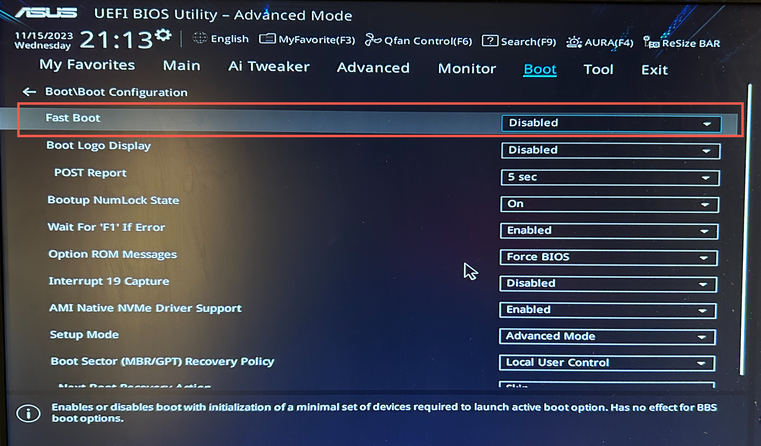

  7. @Cosine I also had the issue of the my new ASUS motherboard royally ignoring my unraid USB key when booting... (and sometimes recognizing it just to ignore it on the next reboot). I tried different USB keys, changing all the wrong UEFI settings (CSM compatibility, etc...), using all USB ports, especially USB 2, "EFI" vs "EFI-"... none of all that made a difference... I also pulled my hair out... way past the 4 hour mark... but finally found the culprit after 2 days: In ASUS UEFI BIOS, you want to DISABLE the "Fast Boot" (it's enabled by default). Mind you, there is zero noticeable difference in boot time, but it now recognizes my USB boot key every time. For reference, to be clear: EFI boot works fine, all USB ports ( 2.0, 3.0, 3.1, 3.2 ) work fine. (I think the solution accepted before should be untagged to avoid confusing future users of ASUS motherboards).
