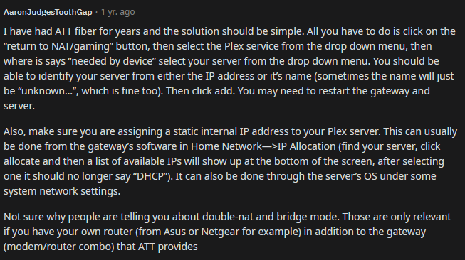

@Squid - I was able to do some additional testing/research. Add'l Details Plex container from Hotio Plex server settings show remote access as working, port manually set to 32400 ATT (Fiber) BGW Router/Modem Combo IP Allocation is set for the server and so is the port forwarding (found the below when searching to confirm I did everything right - link to the old post here) The only oddity I see is that despite my server showing as fixed allocation in the IP Allocation page, when looking on the Device List page, it shows my server as having dhcp allocation. I read when setting IP allocation that regardless, dhcp will still be configured on the client-end - maybe this is referring to what I am seeing in the Device List page... Same as before - accessing the server via ethernet works consistently on standalone desktop Phone via Plex app works consistently if my phone is not connected to local WiFi Any attempt at accessing the server via local WiFi (phone, AppleTV, etc.) results in a prompt that says I can't connect to the server or loading post-pressing play takes forever and eventually generates an error about playback issues and connecting to the server. Aside from the year old post linked above, all my other searches for ATT/Plex issues are about having a separate router and needing to setup IP passthrough.
