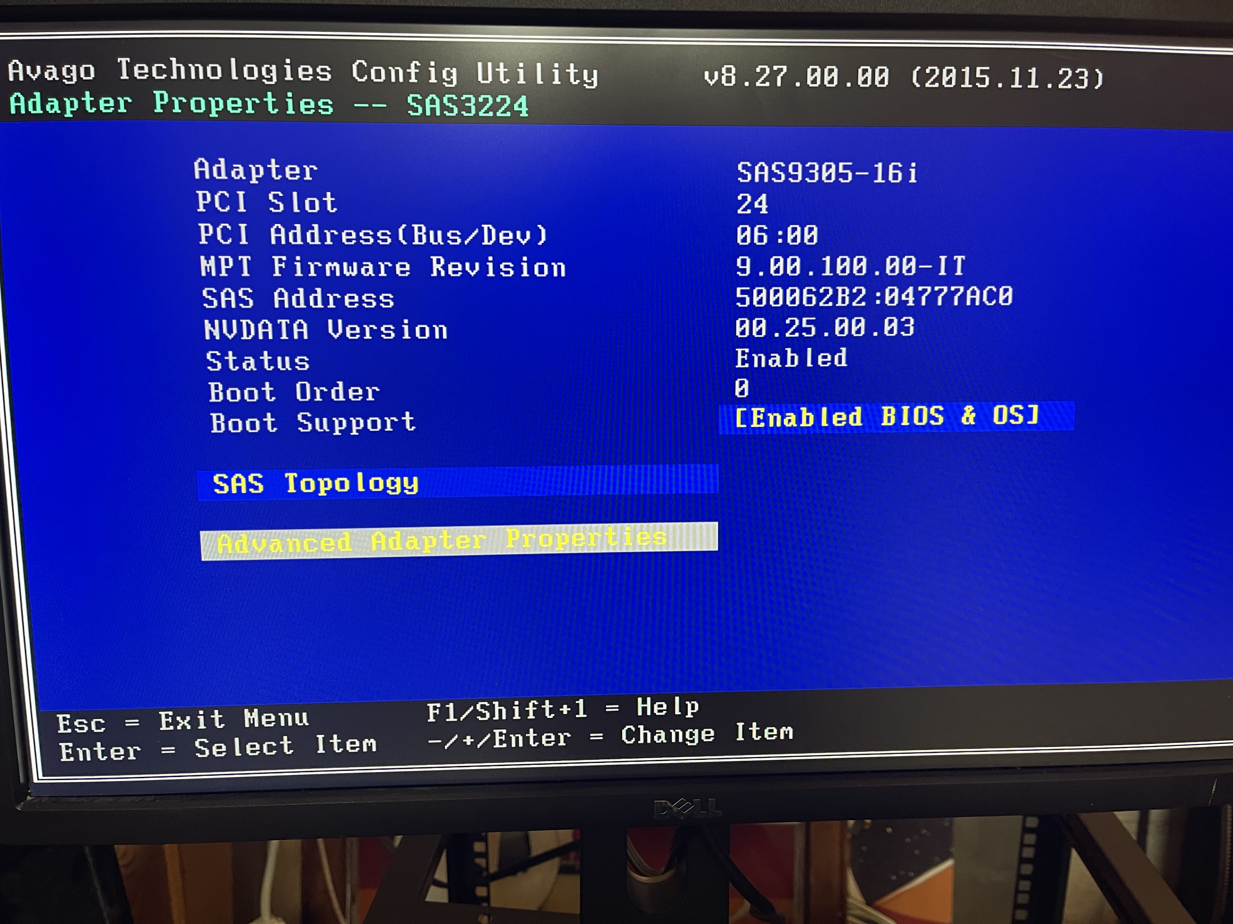

  2. Well, I found and upgraded the fw and bios. SAS drives are still missing in the configuration.
  3. I had two 9201-8is that after reflashing the FW i was able to get going, but I was advised to replace the two boards with one 9305-16i. It finds my sata drives perfectly but the SAS drives not at all. Its on FW 9.000.100.0 in IT mode. I can find the 9305-24i and 9305-16e fws on the broadcom site, but not this 16i model. Can anyone point me in the right direction?
