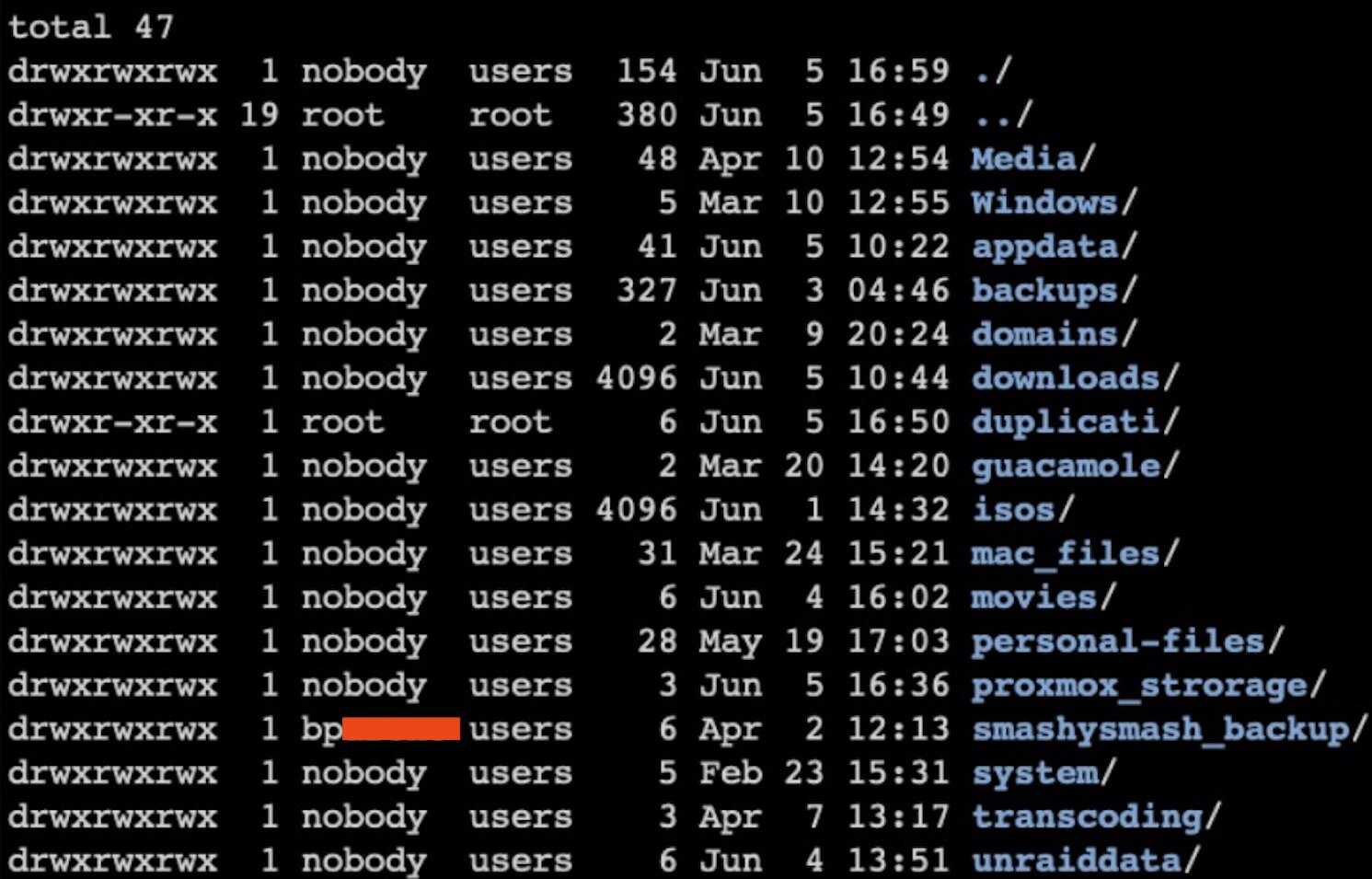

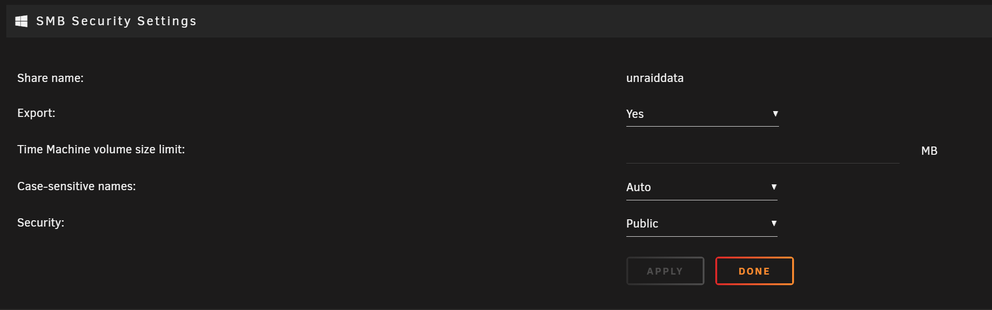

  3. I've never made them hidden. Setting export=no and then export=yes did the trick. Seems like a bug, no? Appreciate your help.

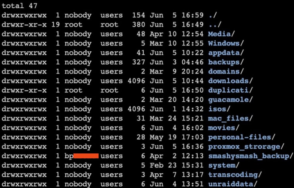

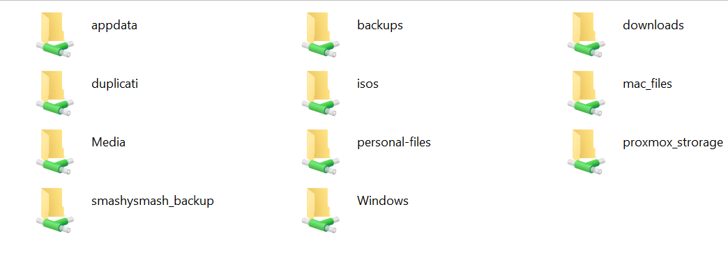

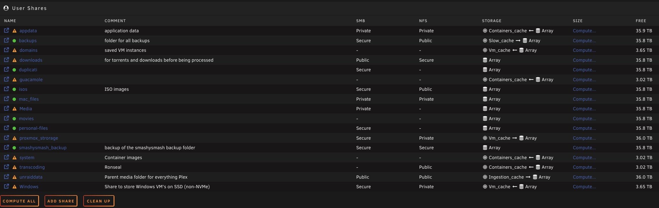

  4. I have a share that is normally set to 'secure' but I've been having issues with it so I set it to 'public', but I still can't see it. I'm on the same VLAN, although my other Unraid server is on a different VLAN and I can still access that one. I have also mounted this share to a couple of Linux VM's I'm hosting on the same VLAN in Proxmox without an issue. When I use Finder or Explorer, I can see 'public', 'private', and 'secure' shares. I wouldn't expect to see the private shares so this is a bit strange. I also deleted a share I wasn't using (Duplicati) and it still shows up in Finder and Explorer. What could possibly be going on? I have 3 other NAS' on the same network, 2 of which are on the same VLAN, and only this is the only one with issues publishing shares so I don't think it's network related. Please help.

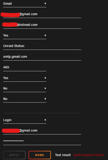

  7. Today my email notifications from my Gmail account to my Hotmail account stopped working. So I created a new Gmail account, set up 2FA, set up an app password, removed the spaces, and tried to get it working. No worky. I tried reversing it with my Hotmail account. No worky. Did something change? My settings seem fine and I didn't make any Unraid changes so I'm a bit perplexed why the working account worked and now IO can't a brand new account working. Am I missing something obvious??? Anyone else having issues all of a sudden?
