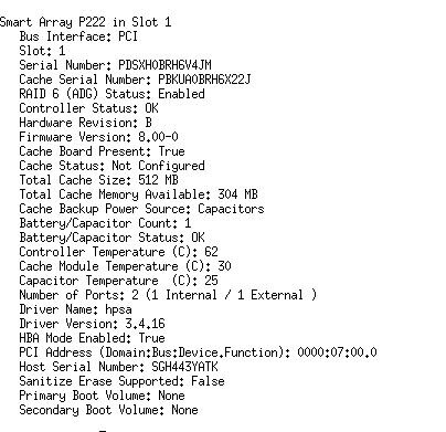

  4. I booted into the HP gui programme for managing this server / controller (HPSSA) which confirms that the controller is in HBA mode, but there is no sign of the 2 SAS drives in any of the menus. I got into the command line equivalent (ssacli) hoping to see more but no joy. The drives are not listed. I am starting to think that the drives (second hand) are faulty but why then does UnRaid see them? Puzzled and open to suggestions

  7. Greetings running latest version of UnRaid (6.12.10) on a HP Gen8 MicroServer with a HP HAB card. The Gen8 has a SAS compatible backplane. The system runs well. I have added two SAS Seagate drives but they are not recognised. See as follows. Not recognised during boot either. System hangs for a while with errors - below. Any thoughts? Thanks in advance. IOMMU group 1: [8086:0151] 00:01.0 PCI bridge: Intel Corporation Xeon E3-1200 v2/3rd Gen Core processor PCI Express Root Port (rev 09) [103c:323b] 07:00.0 RAID bus controller: Hewlett-Packard Company Smart Array Gen8 Controllers (rev 01) [1:0:1:0] disk ATA ST4000VN008-2DR1 CV11 /dev/sdb 4.00TB [1:0:2:0] disk ATA ST4000VN000-1H41 SC46 /dev/sdc 4.00TB [1:0:3:0] disk SEAGATE ST4000NM0043 0006 /dev/sdd - [1:0:4:0] disk SEAGATE ST4000NM0023 E007 /dev/sde - [1:0:5:0] disk ATA ST2000DL003-9VT1 CC3C /dev/sdf 2.00TB [1:0:6:0] disk ATA WDC WD30EFRX-68E 0A80 /dev/sdg 3.00TB May 15 21:49:58 HomeNas emhttpd: device /dev/sdd has size zero May 15 21:49:58 HomeNas emhttpd: device /dev/sde has size zero May 15 21:50:00 HomeNas emhttpd: device /dev/sdd has size zero May 15 21:50:00 HomeNas emhttpd: device /dev/sde has size zero
  8. Greetings. I cant get ssacli to recognise my P222 raid card. I installed a Debian VM and installed the latest version of ssacli (echo "deb http://downloads.linux.hpe.com/SDR/repo/mcp bookworm/current non-free" > /etc/apt/sources.list.d/hp-mcp.list) but ssacli is not recognising the HP P222 card. The error suggests no driver installed, I tried googling and tried starting the driver as follows but no success. modprobe sg I see that the HP driver installed is actually hpsa On the basis of other internet guidance I tried this. modprobe hpsa hpsa_allow_any=1 No joy. Anyone? Guidance from the web I have relied upon https://gist.github.com/mrpeardotnet/a9ce41da99936c0175600f484fa20d03
