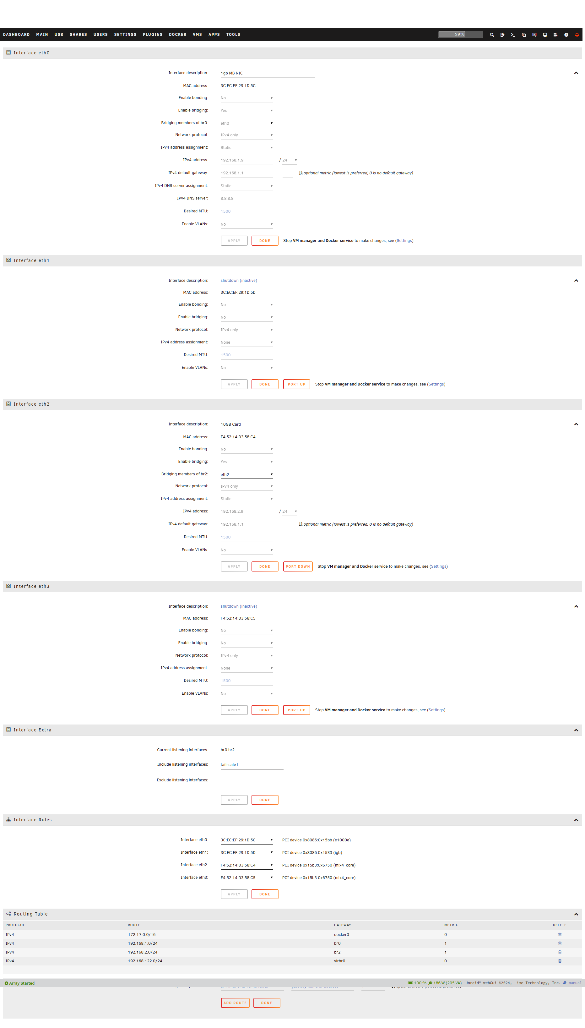

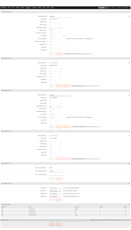

  2. I've installed a IBM 98Y2404 Mellanox MNPH29D-XTR ConnectX-2, 10Gbps SFP+ +2 x10GBs SFP included. Goal was to have a 10gb networks, so I can then deploy a second server and move data between them faster. I cannot get the 10gb card to move to ETH0 in Interphase rules. Every time I move the order around my choice is lost upon restart. I've tried deleting the network.cfg and network-rules.cfg from the flash also. I have also tried to use an active failover bonding with the 10gb in ETH2, however this seems to prioritise the 10gb card. I've tried doing this which I found on the forums: Create a file on the flash: config/modprobe.d/bonding.conf which contains the single line: options bonding primary=eth0 I've attached my log files, and a screenshot of my current network settings. I've currently got the 10gb NIC on a different IP range to see if that helped. I would like the 10gb card to be in ETH0, so that I can set the nic with 192.168.1.9, then bridge for the docker network, and then also have a failover bond with one of my 2 x 1gb Nics on my motherboard I must have restarted my server 35 times trying to get this to work so far. Any suggestions would be great! tower-diagnostics-20250401-1954.zip
