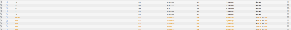

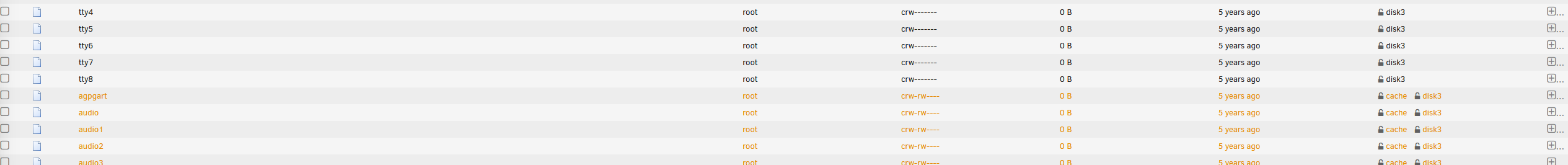

  18. yes, but as you can see in the picture in my previous post, it just says under last modified "5 years ago". This all I can see, and I don´t know how to delete only the old version, if I only see this one file. The only option is, from what I can see is, that I can choose to delete if I click on "cache" or "disk3". I suppose it then deletes the cache or the disk3 version. But I don´t see more information
  19. OK maybe I understand it now. You mean that some file exist on the cache and the array? When I click through, I see that most of the files that are on cache and disk3 are orange. And as I understand it those are duplicates and you mean a I should dele the older one of both? And if so, how do I find out which one is the older one?
  20. OK, thanks, found them. Those are in "user/system/docker/installed/btrfs/subvolumes/random name/dev" . Those are lots of folders with a random name. The oldest are on location "disk3", some of them are "cache" and "disk3", some onle "cache". You mean I should delete just the oldest folder (location: disk3)?
  21. please excuse me, but I cannot follow you. I don´t know what files those are. I clicked through all folders, but I cannot identify what files are meant...
