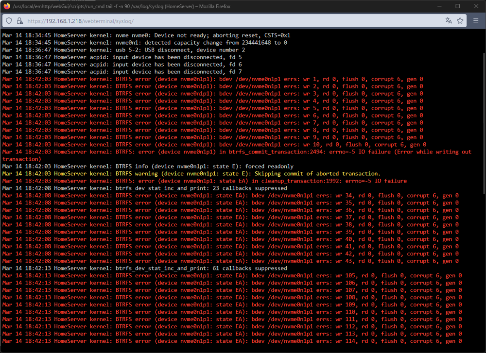

OK, so it seems like it stopped again. Here are the logs. Thanks in advance!
Creating the logs took ages...
I also got this when I clicked on log:
homeserver-diagnostics-20240314-1934.zip
Edited by stainless_steve
NVMe device is dropping offline, try a different m.2 slot if available, or a different device.
