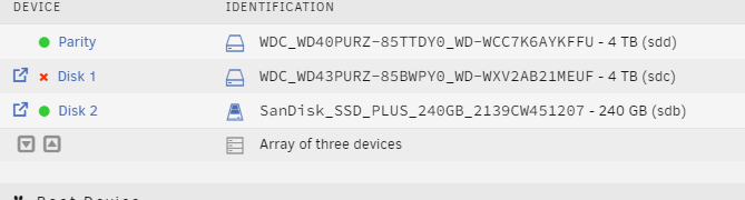

  8. just "disk 1", i already swap the power cable/ sata cable for disk 1, it still goes with X mark
  9. i already change the cable swap the cable but still the same problem on DISK
  10. X mark on one of my disk do i need to replace my disk? here are the sys log and diagnosctics tower-diagnostics-20240423-1154.zip tower-syslog-20240423-0453.zip

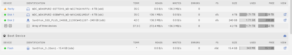

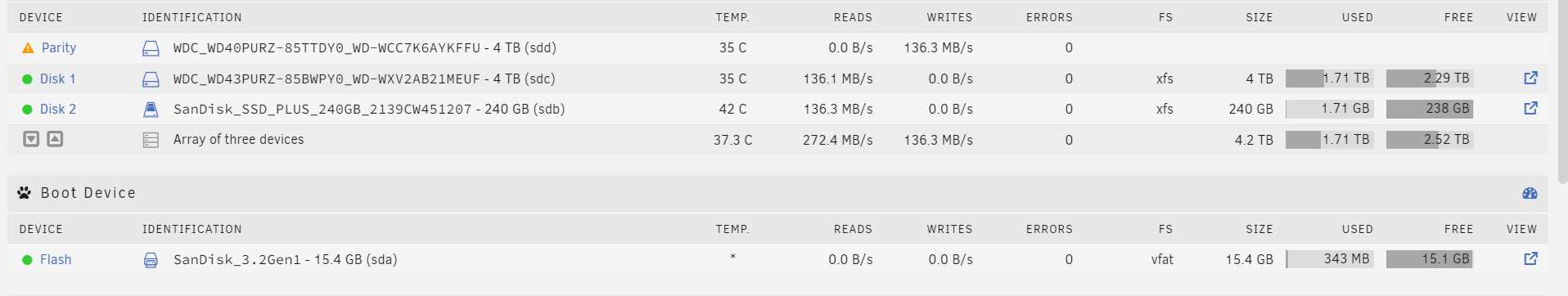

  12. Here is my setup i only get speed around 10MBps tower-diagnostics-20240326-1719.zip

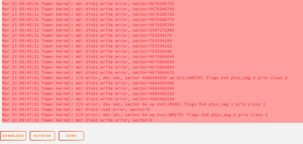

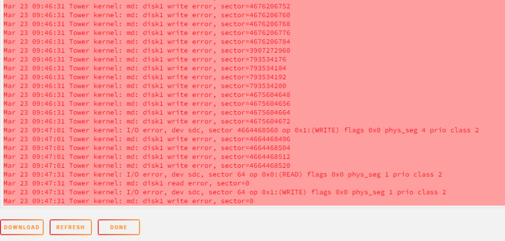

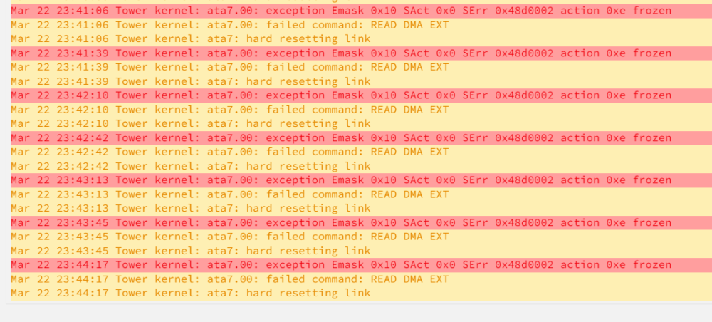

  13. i just switch my cable and this happen, suddenly one of my drive was marked with X tower-syslog-20240323-0252.zip tower-diagnostics-20240323-0952.zip

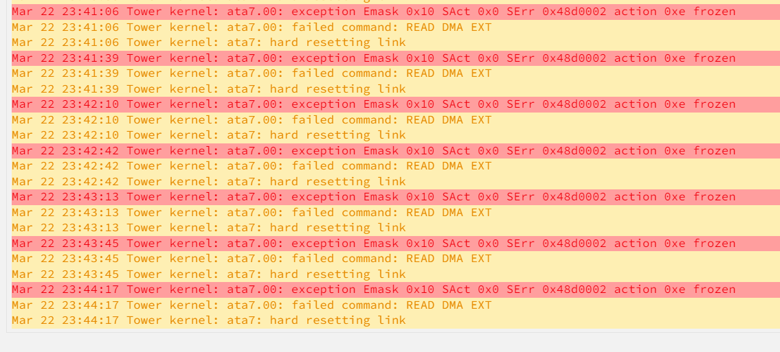

  14. I Got these error, parity check still on progress but it takes to slow arroun 200kBps can somebody help me? tower-syslog-20240322-1655.zip tower-diagnostics-20240323-0022.zip
