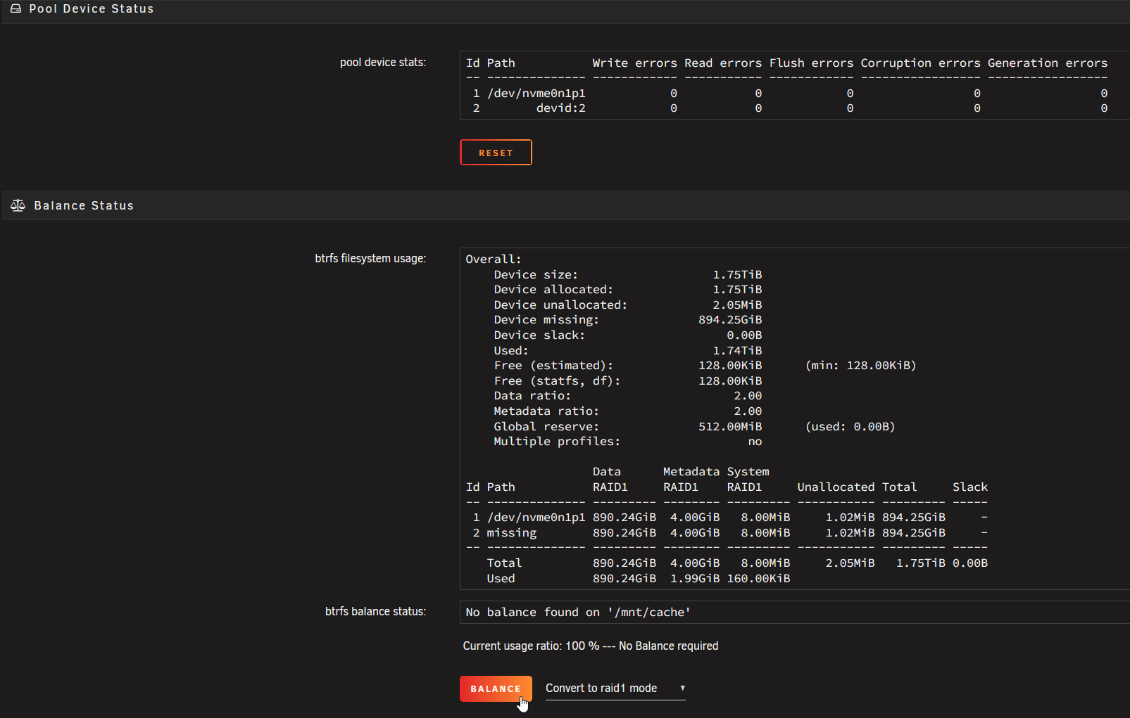

Apologies, I missed to post an update here. Indeed, adding the 2nd 2TB NVMe worked and the 2nd disk has finally synced (RAID1). Still, strange to have all this in the first place, where the newly added disk should have simply replicated the 1st (operational) disk and used to rebuilt the pool. Hopefully the system will be become more "clever" in the future! Thank you.

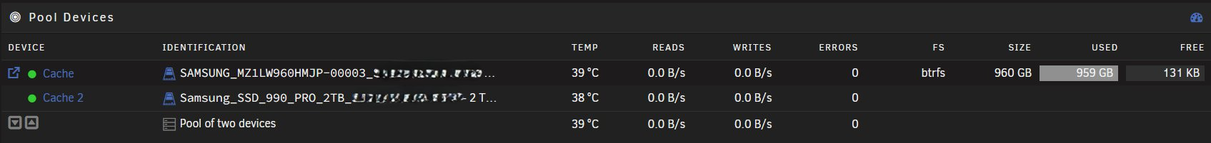

@JorgeB The existing disk (nvme0n1) was 100% full and I thought this might be an issue (I had all docker containers not starting up sometimes). Thus I removed some files to make it "operational". After this I RETRIED your procedure (remove pool, re-add as 1-slot, set the NEW disk as stand-alone and formatted BTRFS, re-insert it as slot-2) but again the same result with the NEW NVME disk (ready in BTRFS this time) not showing up within the Cache Settings (same as my initial post). Then I took another path, I setup the NEW NVME disk as stand-alone and copied all files from the existing disk (nvme0n1) to the NEW one. Then i removed the pool, added a new pool with same name ("cache") and 1-slot, using the NEW disk (nvme0n1p1). This worked and it seems that the dockers and apps operate properly. A couple of questions please: Is there something I may have missed by doing so instead of the proper RAID1 repair? How do you recommend adding the 2nd 2TB NVME to this "cache" pool (1-slot currently) and activating both disks in RAID1? Thank you.

Following the instructions, Pool removed Pool added, same name, 1-slot, auto-FS Indeed, pool showed up as 2-slots added NEW (empty) disk on slot-2, start-array SAME status, exactly as my initial post and images. Here are the fresh diagnostics eos-diagnostics-20250926-1421.zip Thank you.

Hello Team, I have my Cache running on RAID1, 2x1TB NVME disks and needed to updated to 2x2TB NVME (due to being 100% full...). I stopped the array, powered down the server and replaced ONE of the RAID1 disks. I powered up the server and in the missing Cache disk, I selected the new 2TB NVME disk. Starting the array shows the new disk fine in the Main-tab: BUT strangely, the NEW disk does NOT show up in the Cache Settings: So, neither the RAID1 rebuild has not started automatically nor I am able to manually trigger it by selecting "Convert to raid1 mode". What am I missing here about the procedure to replace ONE (1) RAID1 drive and rebuild the array? Thank you.

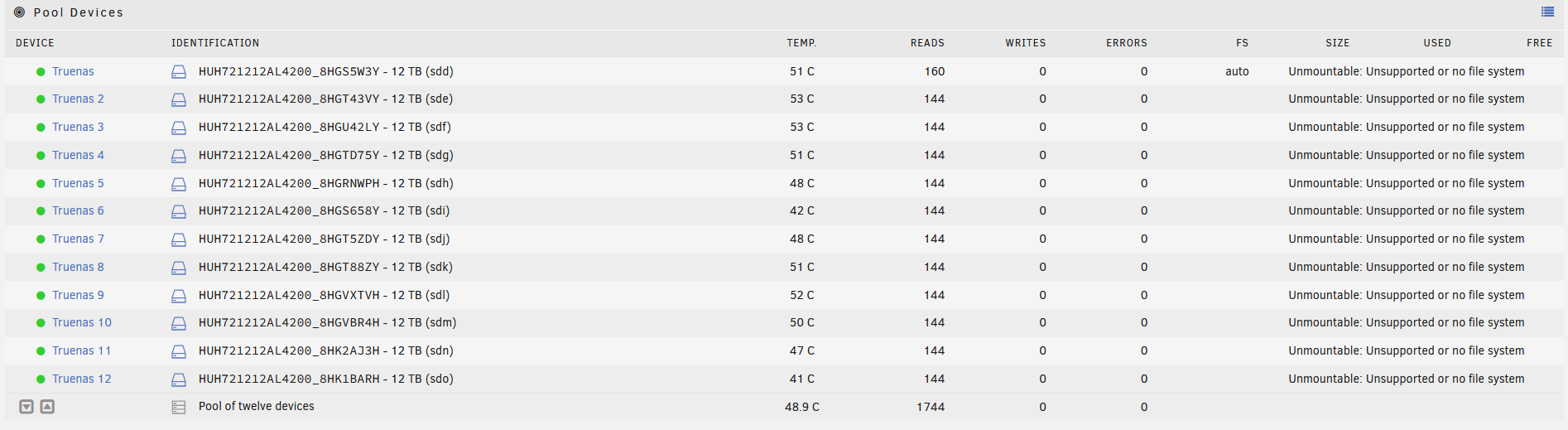

@JorgeB so, how may I degrade the ZFS pool by removing one (1) disk from each raidz1 group and making the pool as 3groups x 3disks? When you say "v6.12 does not support multiple devices missing from a zfs pool", do you refer to web-UI? Could this be done via CLI, by either un-mounting the three (3) disks OR by removing the whole ZFS pool and then add the ZFS pool with ONLY the 3groups x 3disks only? In theory, this Raidz1 pool remains active even losing up to one (1) disk from each group. I even considered the hard(ware)-approach, by physically removing the 3 disks (one from each group) BUT I would prefer the soft(ware)-approach (e.g. CLI). Any proposals on HOW this can be done? Thank you.
How to import existing zfs pools?
In this 3 x 4disks Raidz1 configuration, in theory i can remove one disk from each Raidz1 group and the overall ZFS pool be still healthy (without redundancy any longer). I need to remove sdd, sdh and sdl disks, to start migrating ZFS to array (btrfs). HOW can I remove (unmount?) these three disks and then add them in the array?
