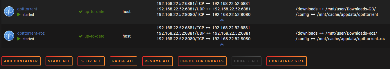

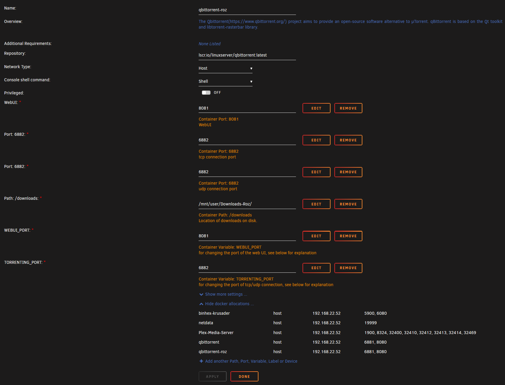

@Squid the 2nd instance works great and installs fine a 2nd docker container. I configure DIFFERENT ports for this 2nd container and i have proper web-ui access in the manually configured port (8081) BUT I keep seeing the SAME PORTS as container-1 under the docker allocations... Why so?
Edited by G3orgios
Added dockers screenshot
